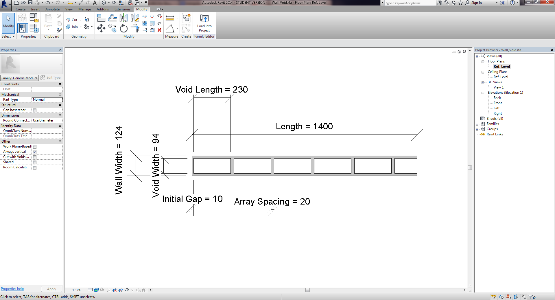

I am trying to make a family of wall having regular voids. I made a generic model and then loaded the family in a project to built an in-place wall.

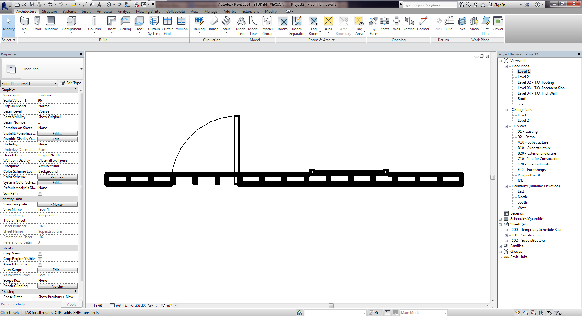

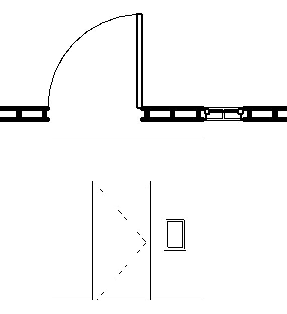

However when I place a door on the wall, the door is not placed on complete width of the wall. Same is the case with windows. Please have a look at the attached photographs.
How can I resolve this issue? Any help would be really appreciated.Thanks!

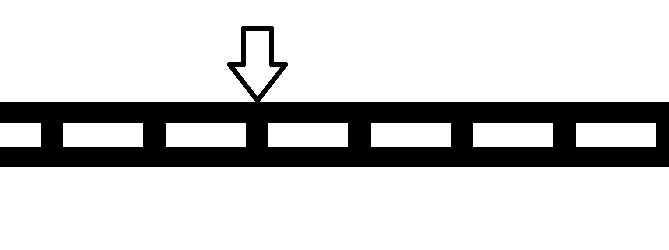

Solution is very simple. I have shared a image. You need to click at that particular position (junction of 2 cavities).  Any other position would make the doors and windows appear attached to only one side of the wall.
