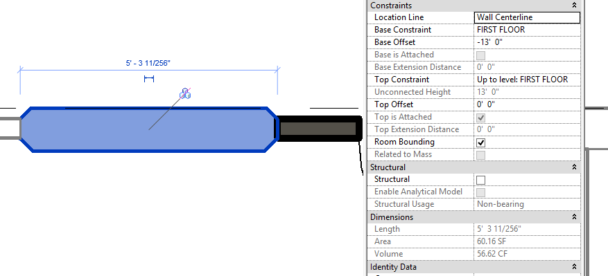

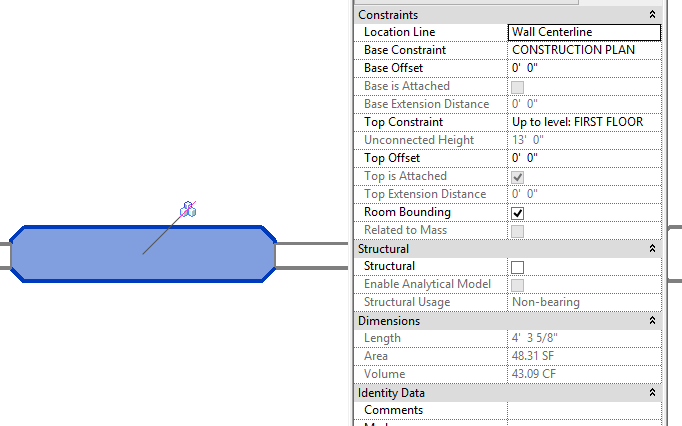

I am trying to do a project for my office and it has a lot of similar walls and casework and everything in it. When I go to copy a wall or a table or a light or anything, it automatically moves the copied item to the floor above instead of keeping it on the floor that it should be on since I am not copying it to another floor. That's not a copy. I am still on the same floor plan and no other floor plan is open or anything. I am not new to Revit. Been using it since 2008 and this has never happened to me. Please help. The photos are the same wall, minus a foot, but I copied and it moves it to the first floor and does a -13' offset from the first floor for the base. This doesn't happen for casework. Casework goes onto the floor above with no offset. PLEASE HELP. We are just looking for a fix because this is a big project and this is not helping us with our deadline

You only show us wall properties so I can only respond to this.
I think this is the same wall in space but obviously, it has a different reference plane that it is working from.  It was built on th "Construction Plan" level and 0 offset for start point.   The copy is built on the first floor so it has to have a negative offset to start at teh same level in space.   So what is the rule here?  If you want it to be exactly the same, then do it from the correct level or edit the base constraint afterwards.

Wed, Nov 19, 2014 at 2:39:00 PM | Copying issue. Objects copied automatically go to floor above
#9
I believe you are having some real process issues.   Here are some possibilities:
  1. Improperly created views - (Views copied, renamed to a different level)
  2. Work planes changed from the associated view level
  3. Items placed on wrong level but set to a different level by the families offset setting
  4. Copying items from a different level because of view depth or underlay
Deleting the floor slab would have nothing to do with the problems you describe.
