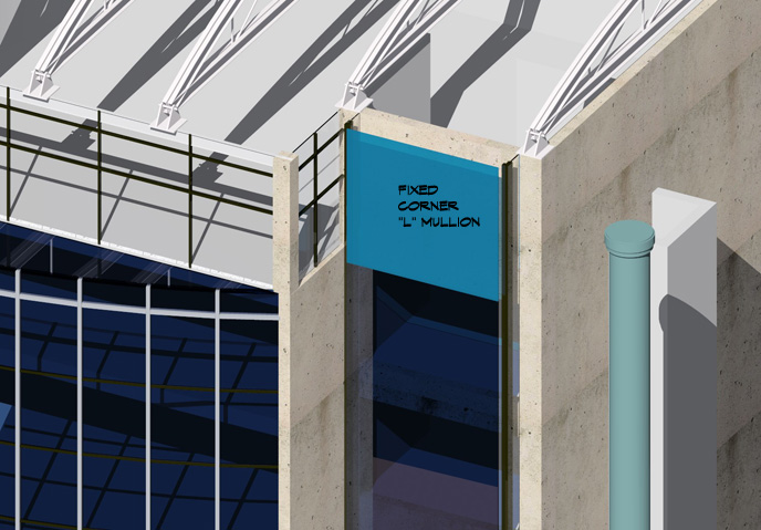

I always have problems with getting corner joins on curtain walls.. I have a box curtain wall..I found a "L" mullion and I turned the curtain walls in a regular wall joined them at the corner and then turned it back into a curtain wall.. The "L" mullion when I put it to the two corners didnt exactly join and there is a space between the mullion and the curtain wall. help.

not sure I understand but yo do need just 1 mullion at the corner, not 2... if that does not answer your Q post and image.

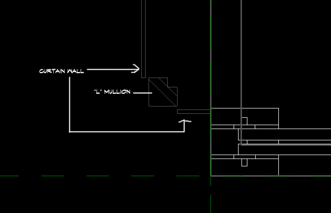

This is what I mean..See the space..

I C... Smile this is because your curtain system panel is offset. in the project browser, go down to families--> curtain panels-->system panel--> glazed right click and go properties, change your offset setting... HTH

hey I tried that and still ..Im getting a space can I send the file to you..

Hey after some messing around I got it .. I actually went into the mullion family and messed with the offset and size.. Ty for your help.
