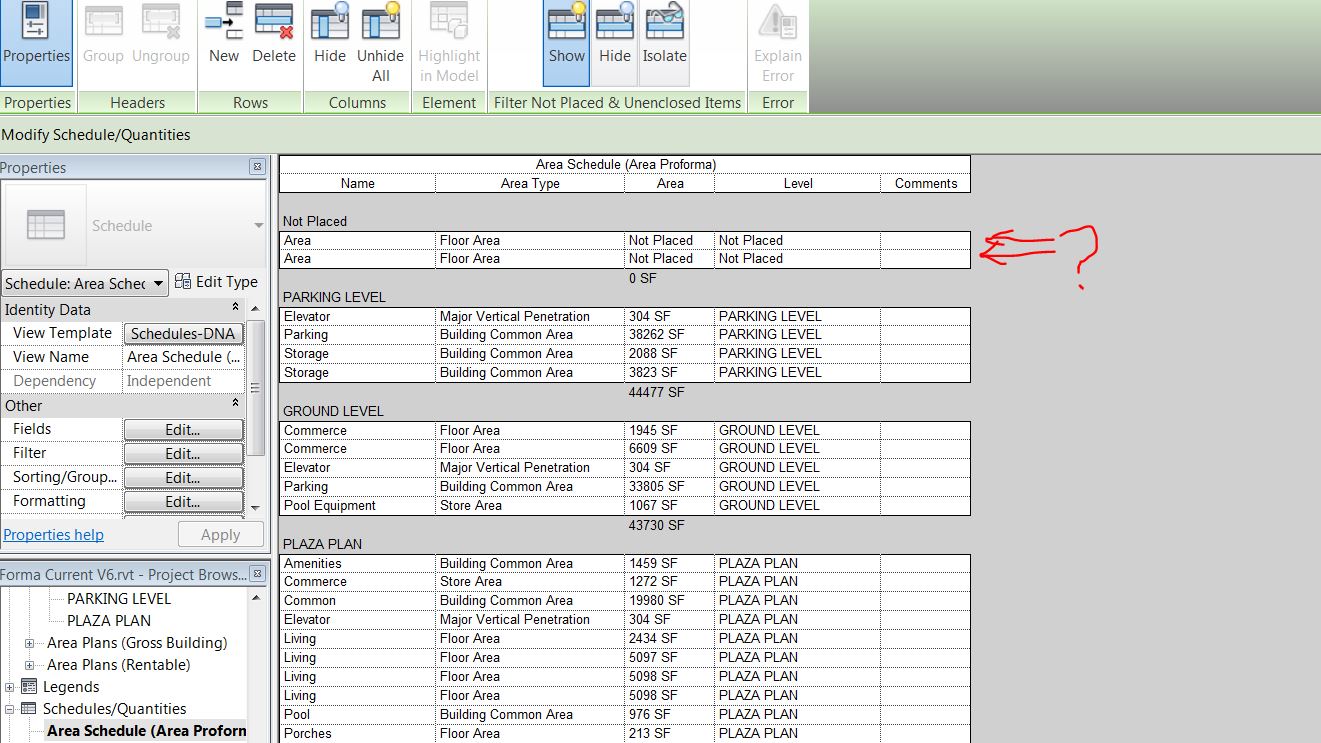

can someone tell me how to find these "not Placed" areas so I can delete them. my area plan is all set up, but these two artifacts are still hanging around. see pic of schedule
revit 2013

Right click on the row and delete the row.   That will delete the un-placed room or area.

OK thanks. dang that was simple. :-)
