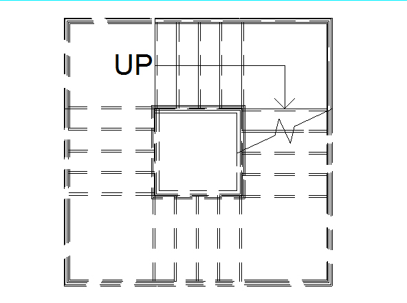

I have a stair that runs up 5 floors.  The riser, etc. set up correctly. The only problem i have is when i exit the drawing mode it creats multiple dashed lines one on top of eachother instead of just seeing one making it look very messy. Does anyone know how to fix this? I've attached a picture.
Thu, Nov 13, 2014 at 10:20:33 AM | stairs
You are in control of visibility.   Under VG/Stairs - experiment with all of the switches for your stairs.   We typically turn off the stairs and railings beyond the view's cut plane.
