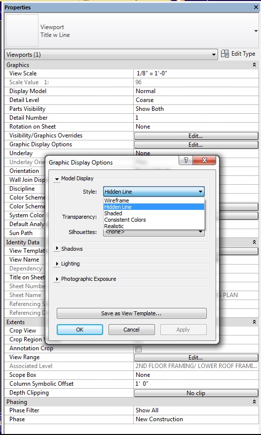

I have a series of Hatched Regions around parts of my plan in color depicting different things. In order to see components through these hatches I set the transparency to at least 50 throughout. I havnt had any problems until recently I went to print & none of my transparancies on one sheet will print. Any idea what is causing this or better yet, how to fix this?

It is only happening in that one view port though. It happens in Print preview, and when I print. I have even tried to delete the view and place it on a new sheet, and I got the same result. Even my key on that sheet, which is referenced by another view port, is turning out right. Any Ideas? I need help fast

I fixed my own problem, but thank you if you tried. If anyone has this problem again, here is how I fixed it. In the sheet, click the desired viewport, in the properties, select Graphic Display Options, and change the Style to Hidden Lines. See Attached Picture for Clearification.

So the views were not the same.....
There are so many variables that problems like this are hard for us to track down.   I now recall people having similar issues because their view was not hidden lines.
