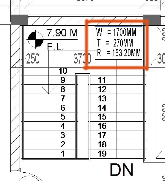

Hi. I need tips on this. Attached is a image of staircase drawing highlighting (Tread, width and Riser) of staircase. I wanted to create this tag family with labels in such a way that all these three are linked to staircase properties. So for any other staircase I could use the same Tagging and would just have inserts the values. Please help and and earliest reply could be appreciated. Thanks.

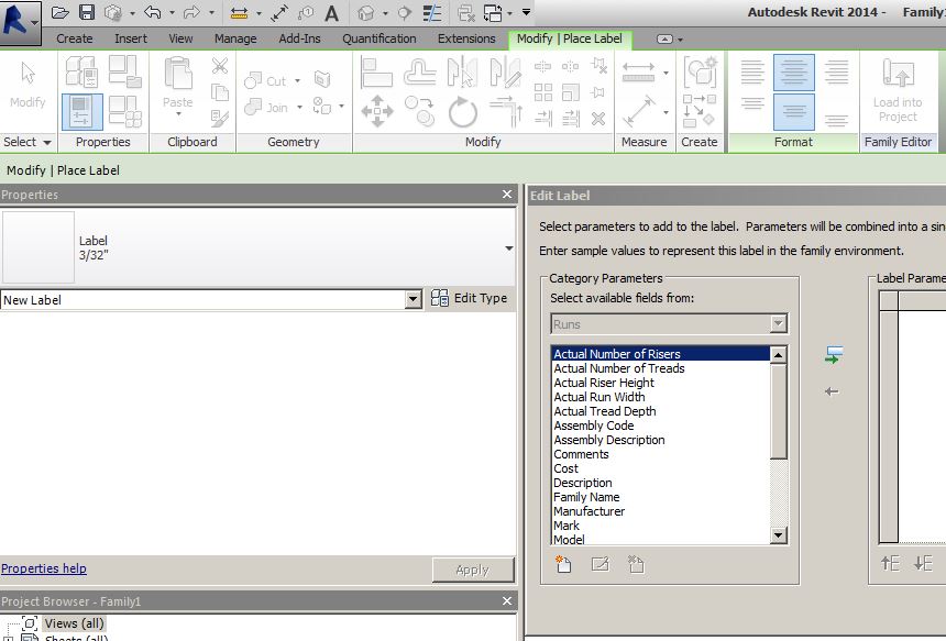

Start with a generic tag, then set the category to stair run and then you will see these options for labels when you add them to the tag.

Thanks a lot! It worked. I had to place prefix and sufix with some spaces to adjust the alignment and it worked out well. Smile
