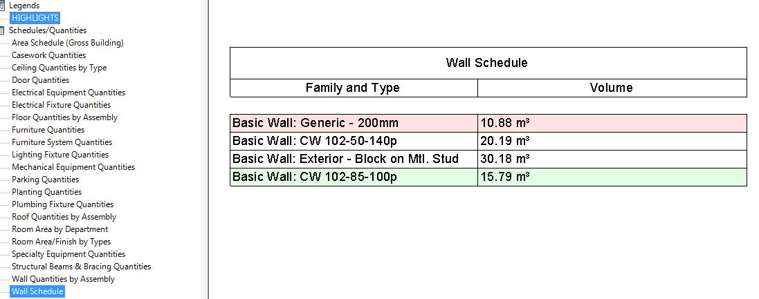

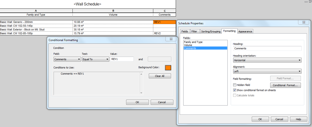

hi andy1602
hope this will give you idea.
there are workarounds you can do
1. use legend and filled region to manually highlight your rows.
2. use the schedule"conditional formatting" if (only if) you need to automatically highlight cells that contains specific revisions.

Hi,
I found that if I inserted a 'Mark' category into the schedule (which can be hidden as you wont need to see it) and assign a number, 100 for example, it is them possible to assign this Mark to various categories under the 'Conditional Format' and assign a colour.
A ball ache but it works!
