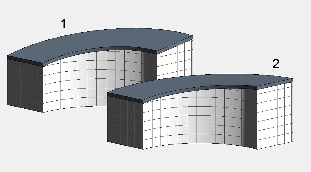

Im trying to do this wall(spline in plan) and having the height in the end and start of the spline; i watched  a lot of tutorials for massing but can do exactly the same thing, if someone can show me with video i will be so thankful

Something like this?
Sun, Nov 9, 2014 at 1:01:03 PM | spline with two heights?
presdes
Joined: Sat, Nov 8, 2014
0 Posts
Yes, exactly! How u do that?
Sun, Nov 9, 2014 at 9:16:21 PM | spline with two heights?
pijpiwo
pijpiwo Avatar
Joined: Fri, Sep 3, 2010
0 Posts
5 Stars: 25 Votes

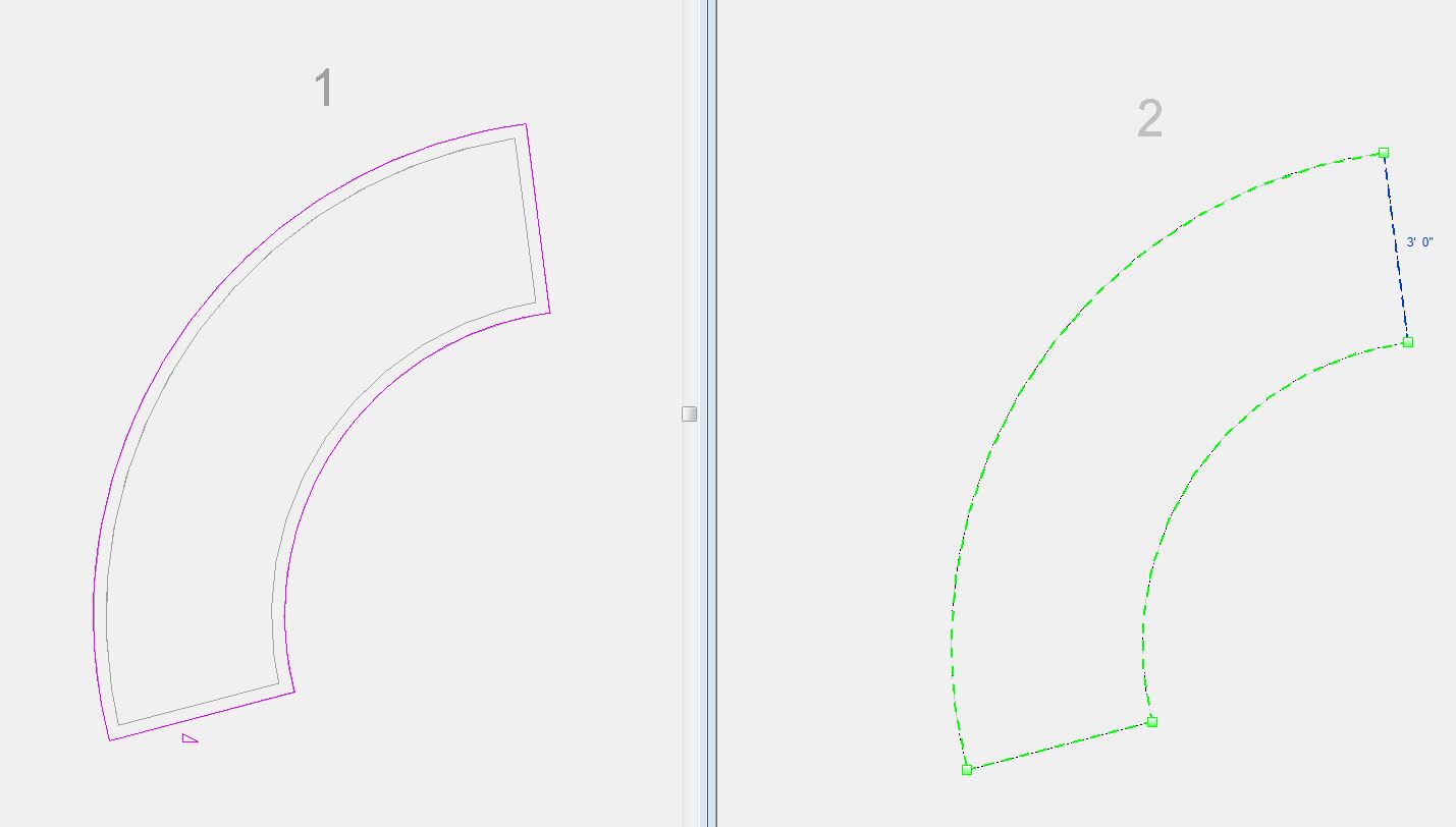

Sorry, but I thought the images were self-explanatory.
Option 1 is just a basic roof by footprint with a slope assigned to one edge (as per image).
http://help.autodesk.com/view/RVT/2015/ENU/?guid=GUID-4EE804D4-CF0B-46C9-AE61-339B78E4EA8D
Second option is also a basic roof by footprint with no slope at all. ‘Modify sub elements’ was used to offset the roof edge by 3’-0” up (highlighted on the picture 2).
http://help.autodesk.com/view/RVT/2015/ENU/?guid=GUID-D7240EA9-28EB-4F51-A474-371FA0DFBFAF
Depending on what option you pick, you will get different roof shape.
