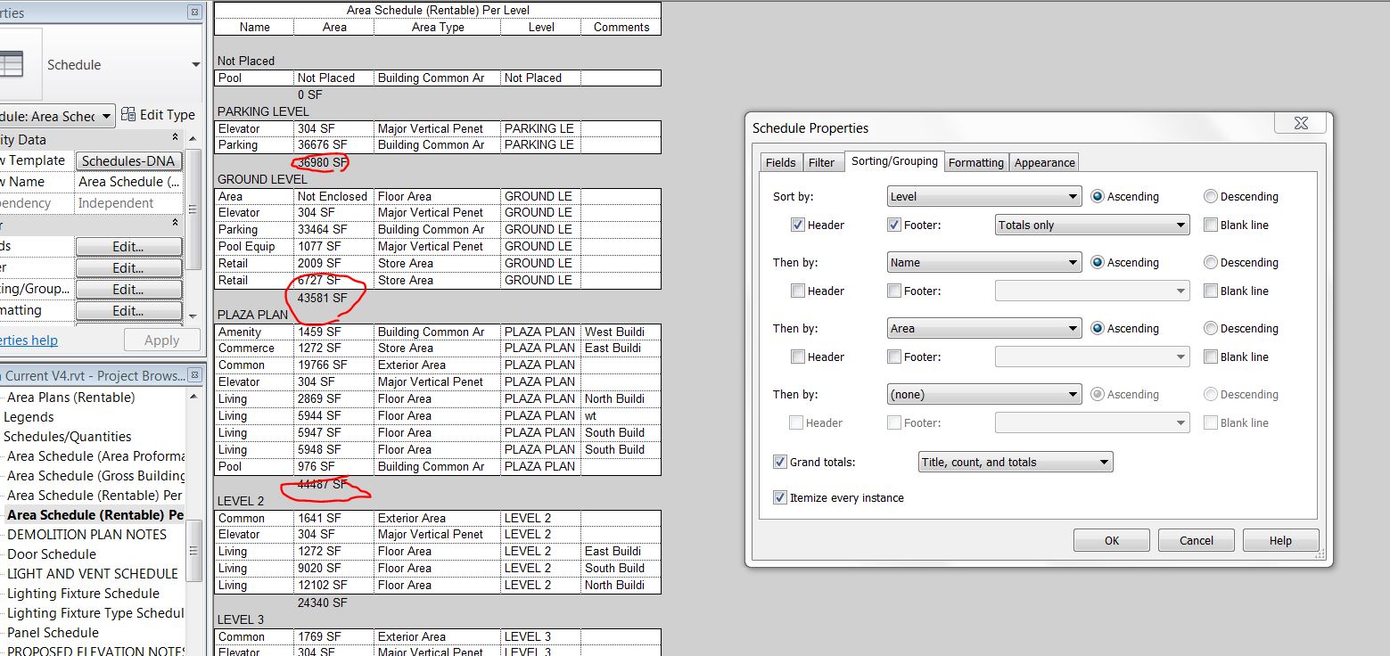

I made a new schedule to match this one in the pic. but in my new one I cant make the totals appear as they do on this image. circled in red.
where is this parameter. I have clicked on and off a bunch of stuff, but nothing for those totals.
My sorting list matches this one exactly. but still no totals.
thanks in advance.
 Edit: after posting the perfect suggested link came up. In formatting, you have to click the box "calculate totals"
like this
http://www.revitcity.com/forum_files/125810_Untitled.jpg
Edited on: Thu, Nov 6, 2014 at 1:23:58 PM
Thu, Nov 6, 2014 at 1:28:50 PM | totals in area schedules
From the schedule properties, goto the formatting window and for the area field, check the total box.
