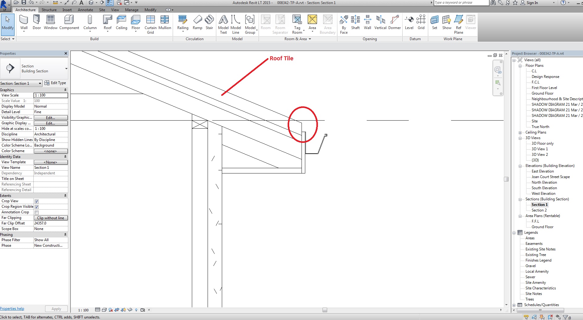

hey guys is there a way to show part of the roof structure (tiles) curved into the gutter?

do the roof tile layer as a separate roof maybe, with sufficient overhang to sit between front and back of gutter.
pick a relevant section view after making, select the new tile roof and move vertically to suit.

like two roofs? that probably cause other issues down the track though.

think of it not as 2 roofs , but 2 layers.
first roof would be the rafter plane
second would be the tile thickness.
gap between the tile batten space.
in a section you would insert some tile battens ( detail lines maybe) in the gap
between the 2 roof "layers".
just one way of acheiving what you want.

yeah true. Thanks for the help will have to give it a go.

You could try using the cut profile tool under the veiw tool.
