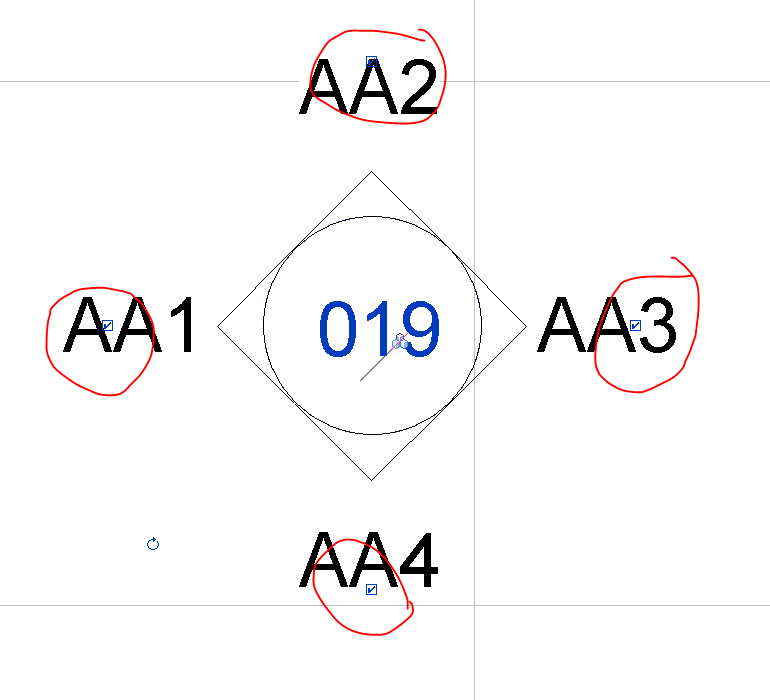

I have created an annotation familly which have 4 arrows in 4 directions (x,y), And I want to choose, just like with the elevation family, which arrow will be shown with check boxes. Does anyone how can I do it?

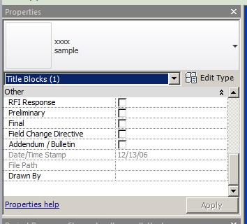

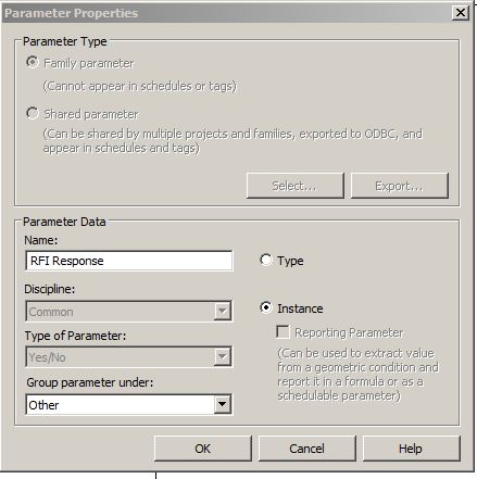

An instance parameter in the family that is yes/no will give you a checkbox in the properties window

Great, that helps! Is that anyway I can have the checkbox on the screen close to the symbol. Like in the attachment.
Fri, Oct 31, 2014 at 10:50:36 AM | Checkbox on annotation family
No way that I can think of.
