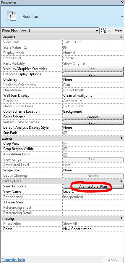

I am trying to create a foundation plan but the View Range button is grayed out in the properties  dialog. How do I change this?

Is there a view template applied to the view? Set to none, or change the view range in your template, or exclude View Range from the template.
