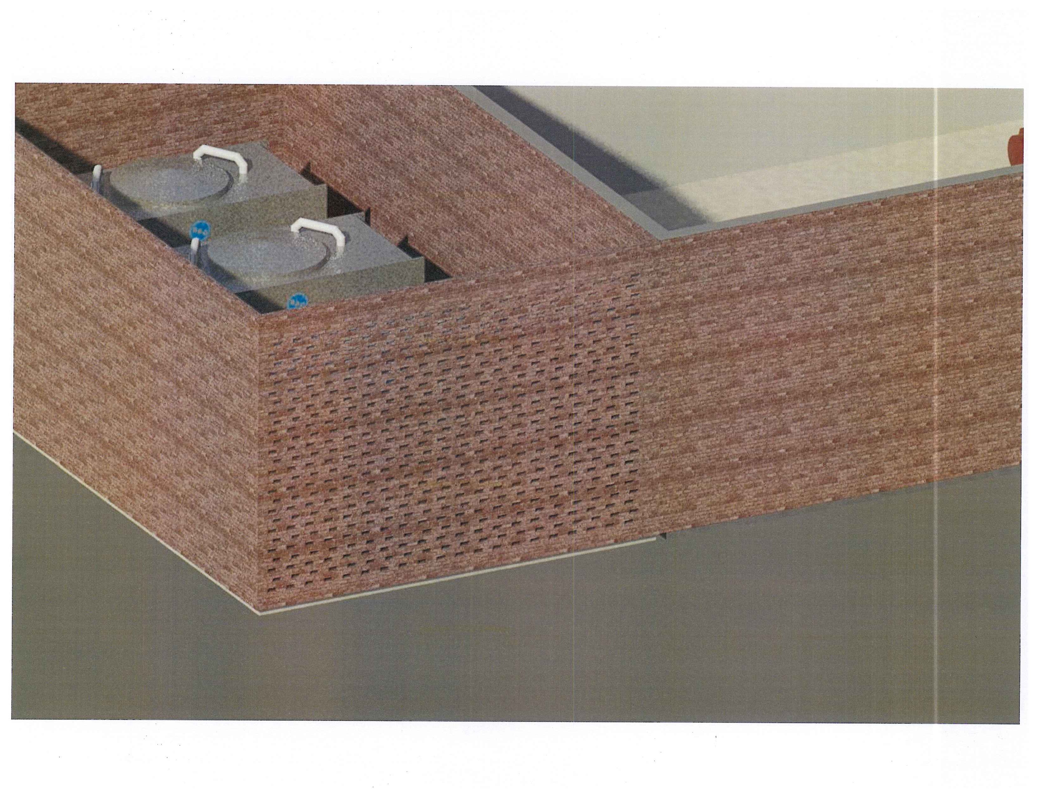

here is an image of what i had done. but like i stated it locked up the program having all those openings in 3 walls. it looked great. when i rotated around the building you could see the cooling towers through the wall.

Thu, Oct 30, 2014 at 2:43:14 PM | perforated brick screen wall
Don't do multiple openings.   Do as I showed, one void (in-place family) sketch on each wall face.
