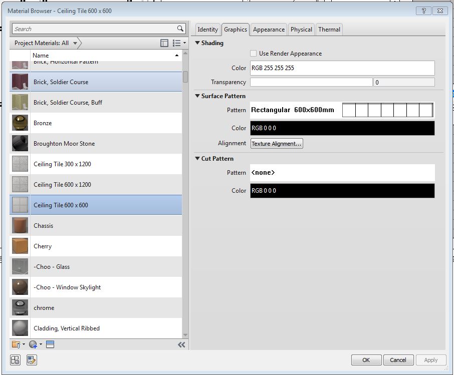

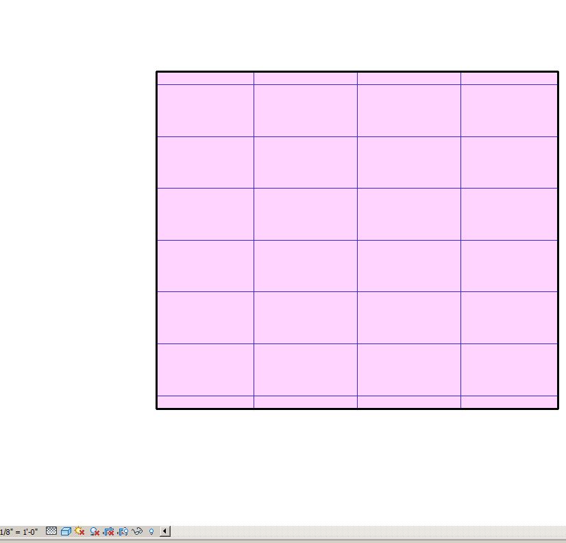

See 1st image:
Set your view to shaded - create a material with a shaded color - see second image

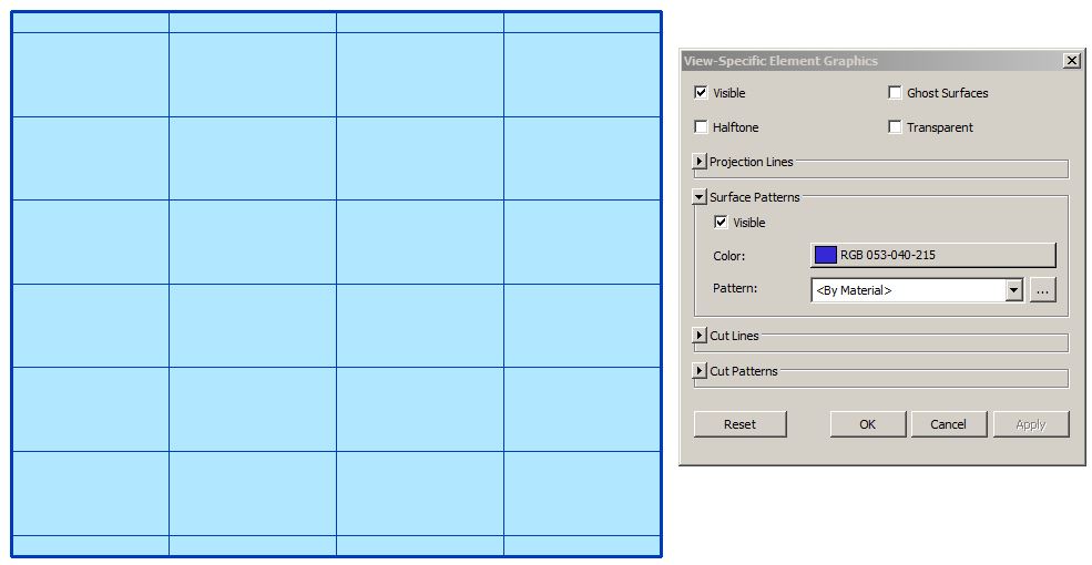

For colored grid - over-ride graphics in view - see 3rd image

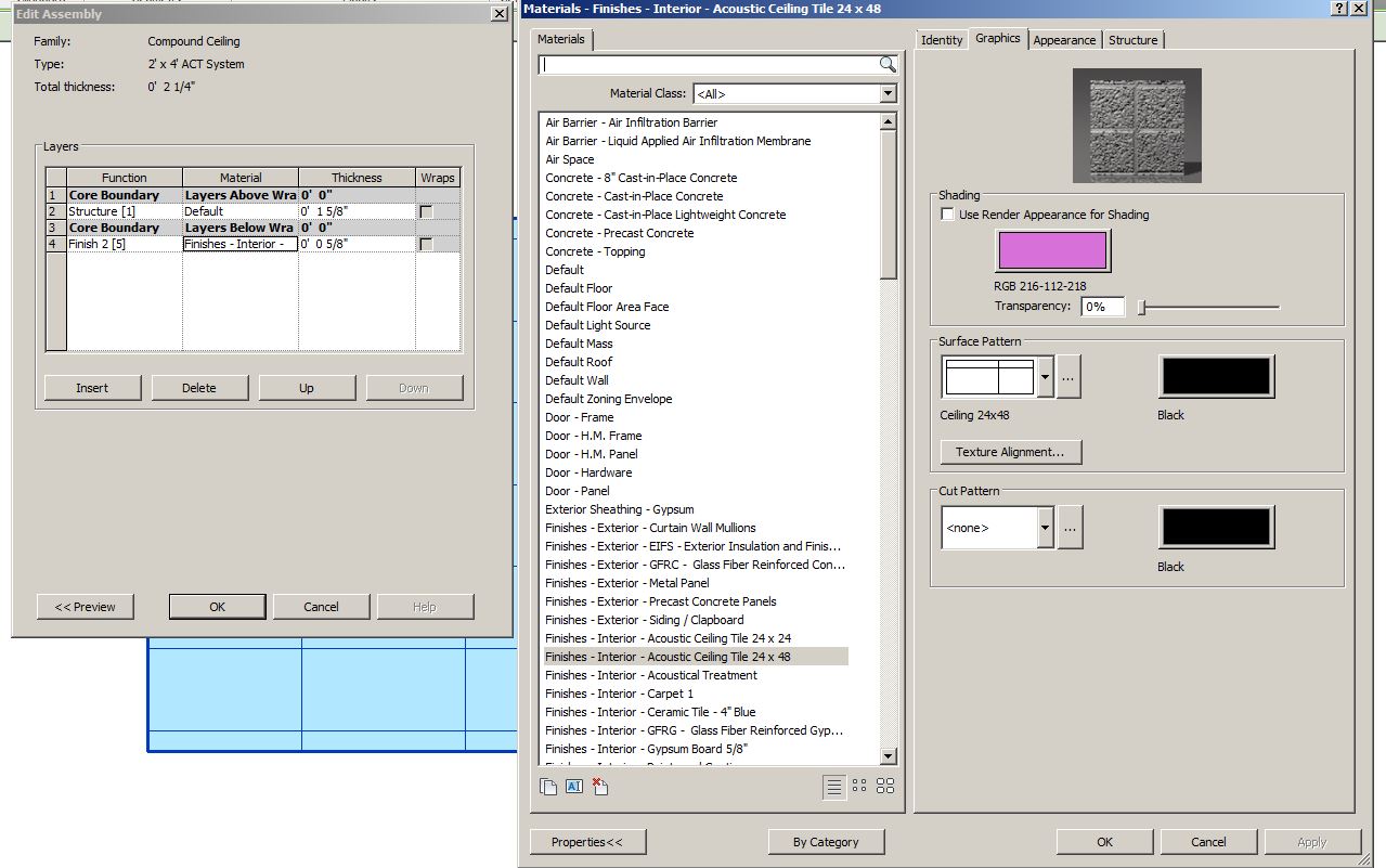

It seems that there was a problem with the material I created for the ceiling. I had previously duplicated the generic Revit ceiling tile and changed the hatch pattern to what I required. However with this material even when you change the colour in the material pallette it doesn't alter in any of the views (see attached). I can't work out why. So when I made a new material for the ceiling, gave it a colour and a hatch, voila! It worked.
