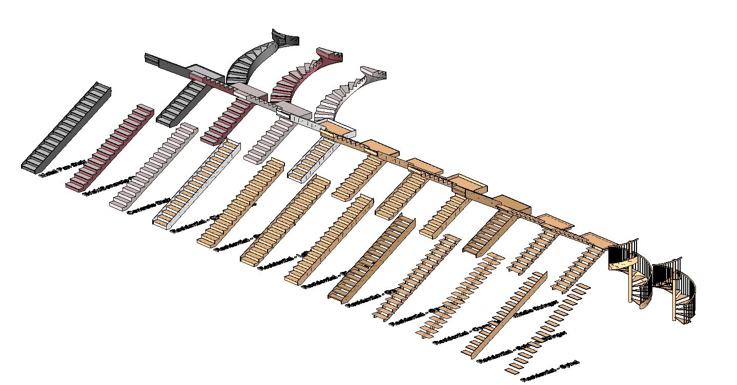

The attached image shows all of the stairs you can create ujsing Revit's standard stairs.  Yours are there - you just have to study the process.  Try watching some videos and reading about stairs in your help.

There is no such item in spiral staircase definition.  You have to add one seperately.  Use a round column.

Your question sounded like you wanted a column so I answered you that way.   If you had looked at the image of stairs I posted, you would have seen that there was a straight one with only a center support.  This can be defined in your stair types.   The stairs I posted are all on line in the old Revit library.   So I edited that file to just use that stair definition in one of the circular stairs.   Here it is.
