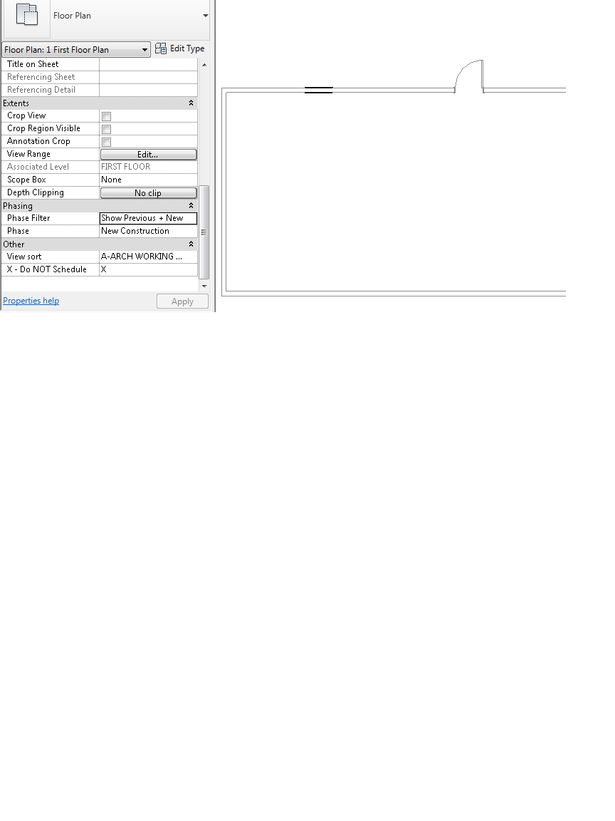

Working in Revit 2015.  I have a consultant’s structural model that I have linked into my own architectural model.  With their last update all of the existing structure (beams, columns, etc.) that we are demolishing in the New Construction phase are now showing up on all of my new views.
I don’t get it.  When I select the linked elements or even when I open up their structural model, the structural elements show up as Phase Created: Existing and Phase Demolished: New Construction.  All my view phases and phase filters are set up correctly as all my stuff is still showing up as it is supposed to.  This is happening on all views, floor plans, elevations, ceiling plans.
Is there any reason why phase filters wouldn’t override a linked Revit model in a given view?  Any help would be greatly appreciated.  Thanks.

I don't understand why you say my comments are wrong.  The views are not linked, just the model.  Check out this quick set up I created to show you what I mean.  In the host model the demoed columns show up in the new floor plan.  This is soley becuase in the linked model the phase filter is set up to show demoed items in this particular phase filter.  No linked views, just linked model with different phase filter set up.

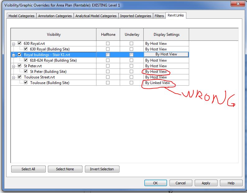

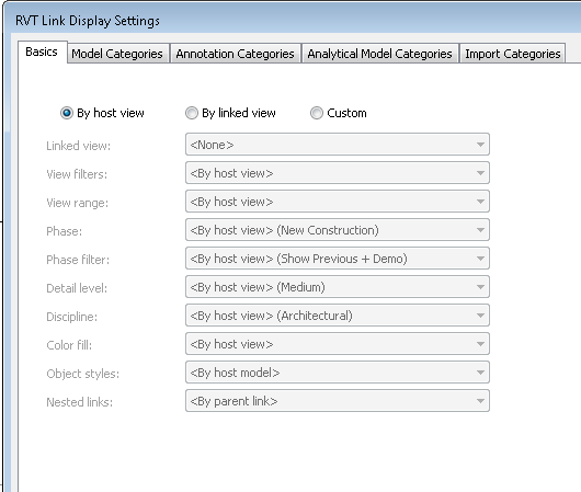

#9
Look at my second and third images.   The second image is a 'demo' plan and my phase filter is set in the view.  The 3rd image is the VG for that view and is Revit's default setting.  It shows the phase is per the view and the phase filter is per the view.  You can pick custom and change these but YOU have to do that.  It has nothing to do with the link's settings.
Phase filters are VIEW settings - not model.  As such, they can be set differently in different views and often are!    The phase of elements are model settings.    Obviously, for this to work correctly, the phases of both models MUST match.  Existing is the same existing in both models.... not some new, added phase.
So if you are NOT linking by view, then the consultatnt's view's phase filter settings have nothing to do with your model's view's phase filter settings.
Understand?

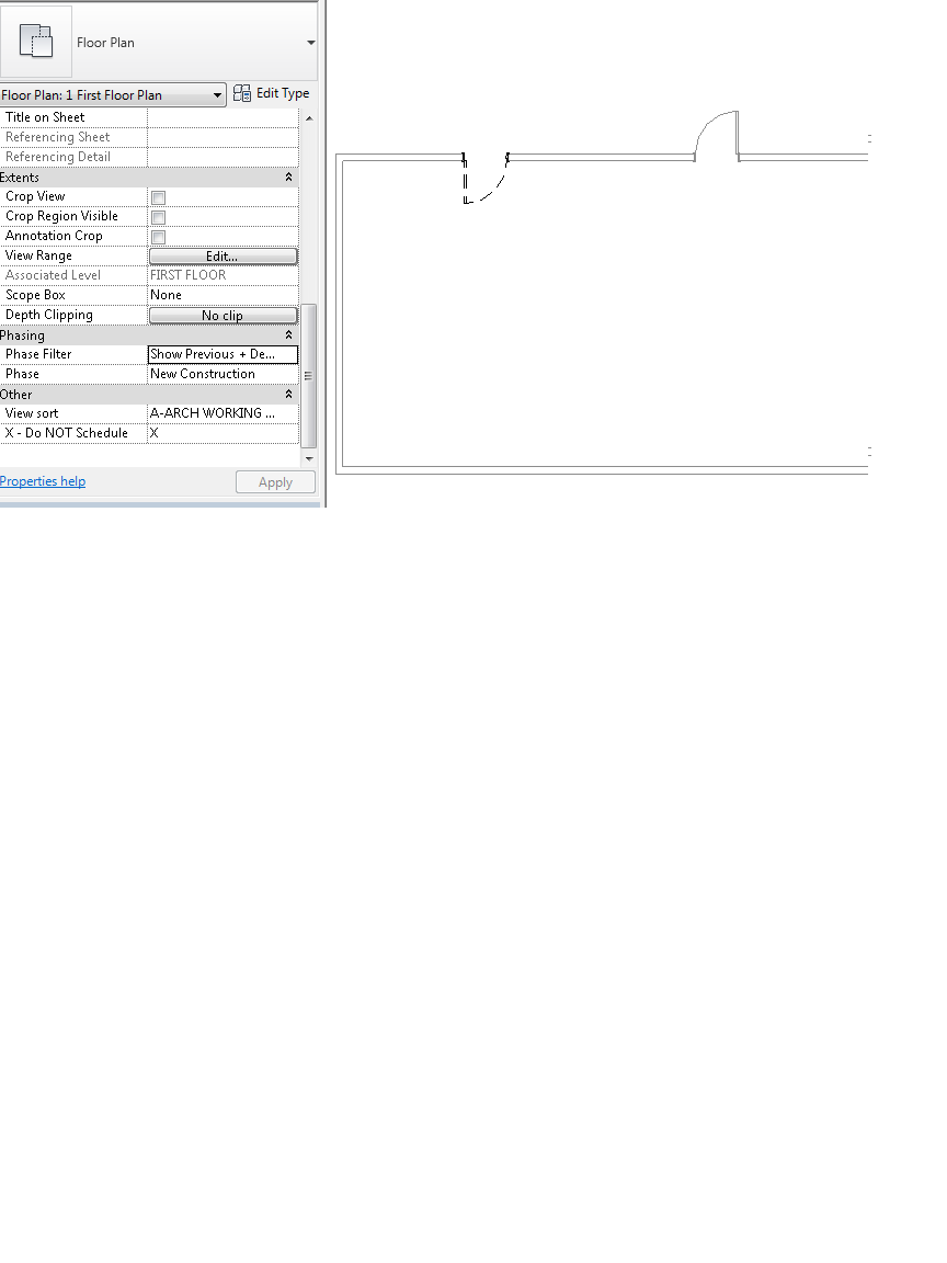

I thought for a moment you had me and I missed something, but I still don't think you are getting it.  My RVT Link Display Settings are all set to By Host.  So the Phase Filter is set to draw from the same host Phase Filter name, but again, it pulls what the phase filter settings for that named phase filter for the linked file, from the linked file.  So even though you have the same name phase filter and the linked files phase filter set to By Host, you can still get two different filter settings if you have different settings for each of the same named phase filter in the different files.  I know, I know this is very un Revit but I swear to you it is true.  Try this simple experiment if you don't believe me.
New file in Architect Templet.
Draw a wall as existing, demo it in new construction.
Go to phase filters and set the phase filter Show Existing + New to show the Demolished phase to By Category.
Save and close.
Now link this file into a different model.
Set a view to be phase New Construction and the phase filter to be Show Existing + New.
You will see that in this host model, even though you have not messed with the Show Existing + New phase filter, even though the phase filter is still set to Not Display the Demolished phase and even though the linked file phase filter is set to By Host, the linked file still shows the demolished wall in this view.  Try this and then tell me I am wrong.
Tue, Oct 28, 2014 at 11:51:38 AM | Phase Filters not working on Linked Model
#11
You are correct.  Although Revit says to use the host model settings, it does not.  I checked in 2012 and it worked the same.  The HELP explains this problem and shows it the same from 2012-2015.  So I checked 2011, the oldest program I still have installed, at it too had the same problem.  I have never seen this done before so I don't know if it ever worked correctly.  My Revit 9 'User's Guide' manual does not indicate the problem.
