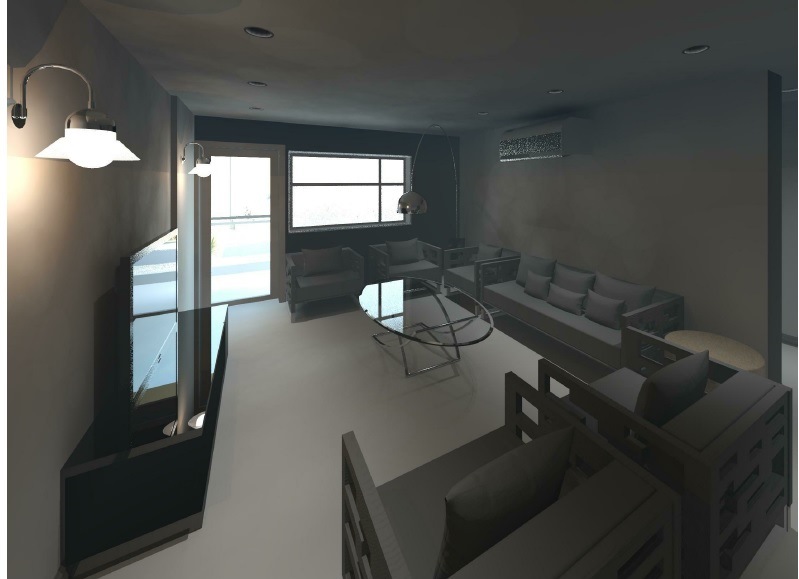

i've alittle issue when i used to render (interior render) all the data inside show by grey colour even it had a nother colour over family
what should i do?
plzz any help ......
u can see attached below for my render.

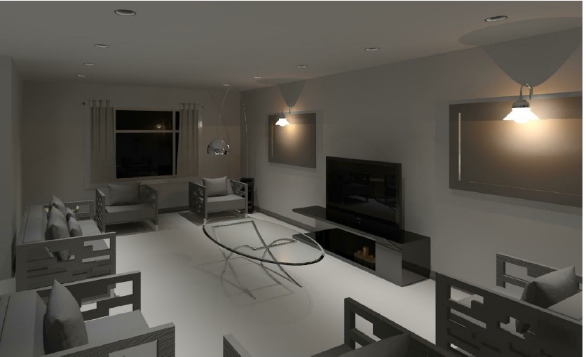

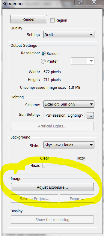

You probably need more interior lighting or a portal. Interior renderings require lots of light. Also you can dramatically alter the brightness and contrast etc after the render is done using the Image > Adjust Exposure dialog box. See attachment.

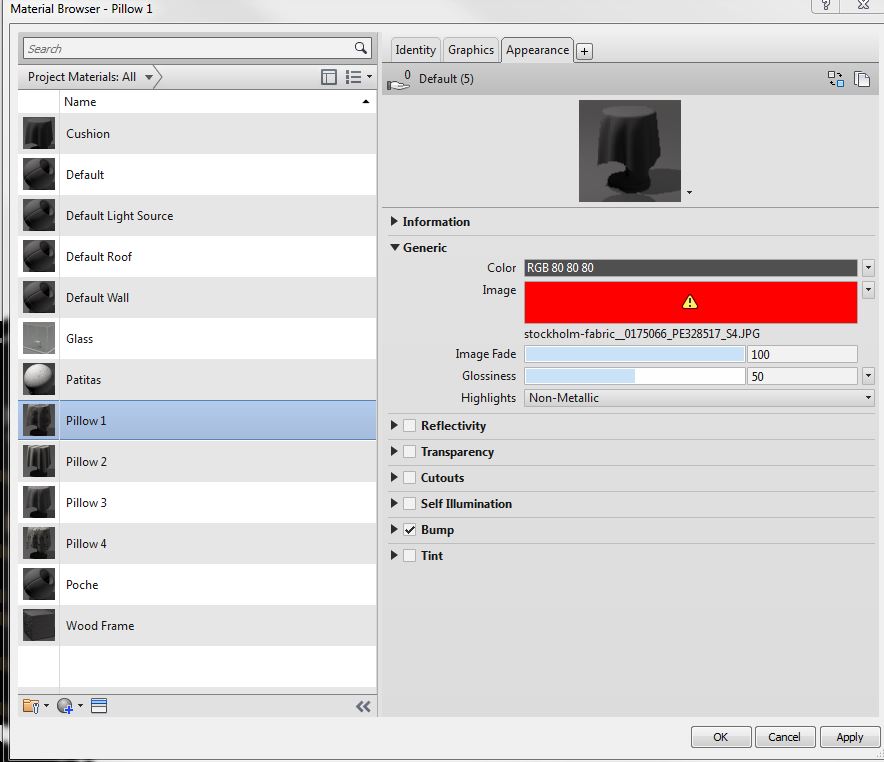

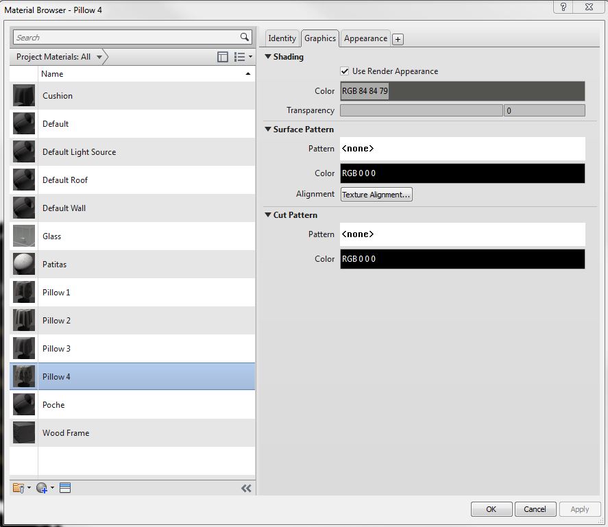

Just so you know this is a CAD file imported into a Revit family.  You need to fix the materials in the family itself.  As you can see from my images you are missing the image files for the materials.
