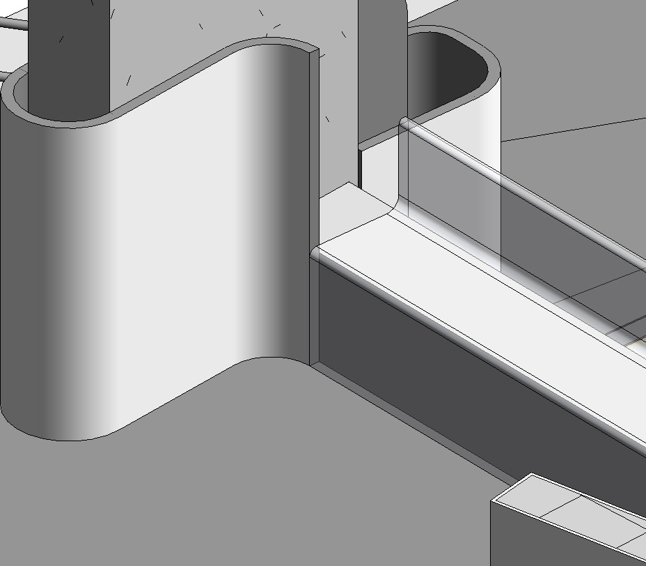

So I was going to make a custom sitting place around a concrete wall in my project. I tired making an In-place mass which at first was
going well. But then When I add other walls which interferes with the in-place mass, it rotates. I thought maybe I should make the sitting place a family and insert it. But then I need walls and floors of my project to build the sitting around them.
I attached a screenshot.
Any idea what is the best aproach to this?
As I said at this stage which you see on the picture, everything is alright but when I want to add walls near the sitting place, it reacts and rotates.
thanks
Tue, Oct 21, 2014 at 7:13:45 AM | What is the best way to Add a custom mass object to your project
DON'T USE MASS!!!!
Do an in-place family in the correct category.  That's what that tool is for.
