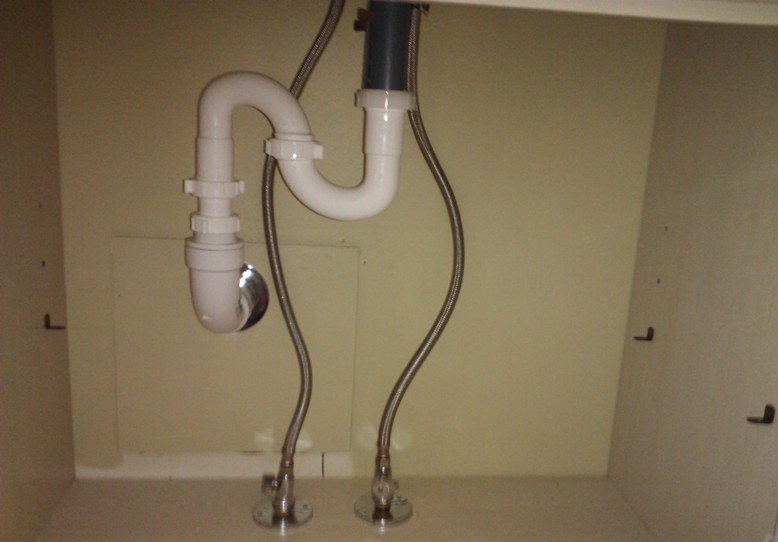

HELLO I'M USING REVIT 2014 AND I'M TRYNG TO MAKE THE SINK AND TOILET CONECTIONS FOR WATER BUT ALL I GET IS ELBOWS AND PIPES. I'M POSTING PICTURES TO SHOW WHAT I MEAN. I DON'T HAVE THE FAMILY FOR THE HOSE OR VALVE. DOWNLOADED VALVE BUT WONT STICK TO WALL WHILE IN REVIT MEP. ANY ADVISE WILL BE APRECIATED.

Modeling pipes and valves as they would be installed can be very challenging if not impossible.

Hello and thank you for response. I agree and this creates more work for documentation.

What we have done is just show the supply lines over to the fixture and then keynote depicting exactly how it is installed or how you would like it to be installed.
