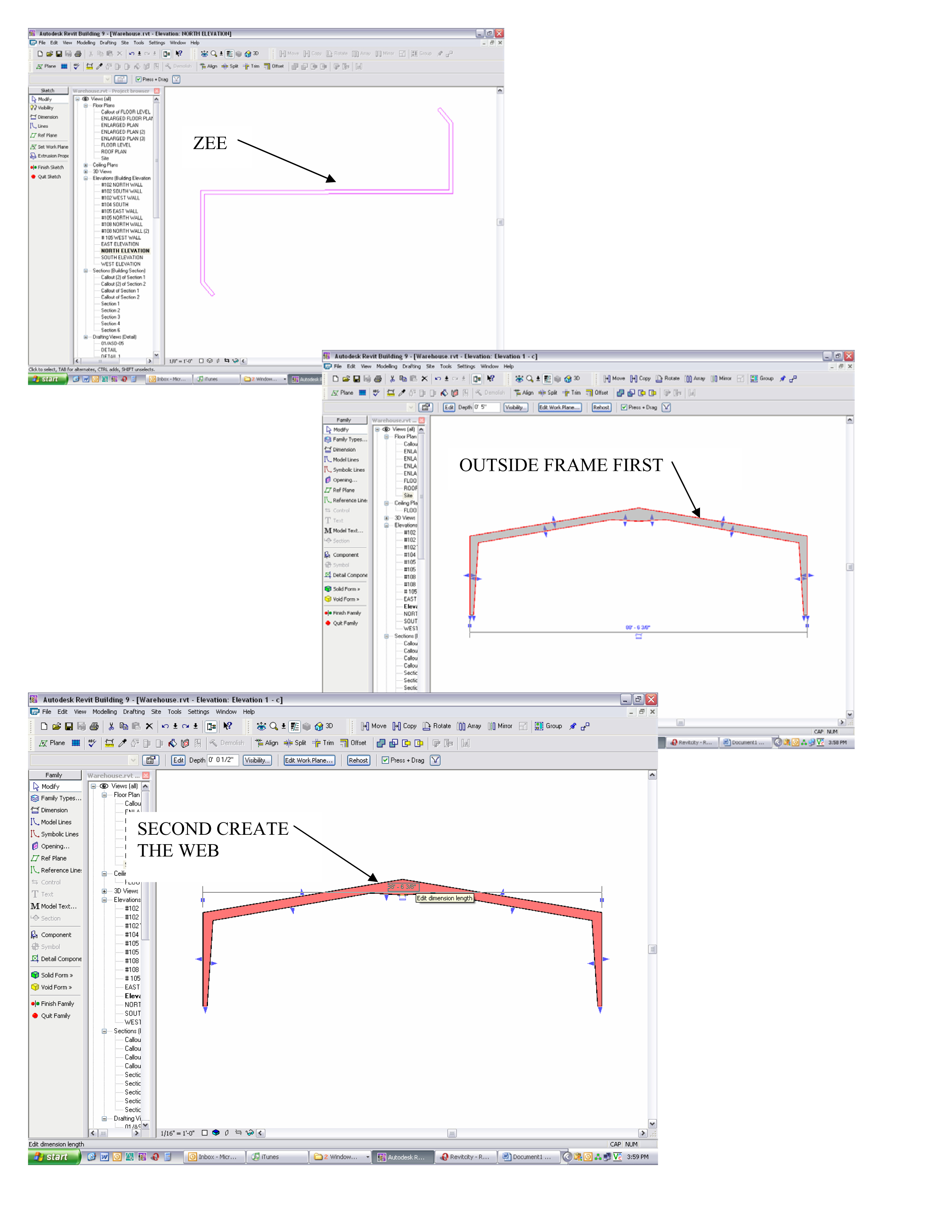

Looking for all the families I can get for metal buildings. Or tips on creating horizontal framing members(Zees) tapered frames, wall poanel Thanks

Danm Sky...me to...funny you should mention that, I'm just gonna start building a tapered frame family today

Does anyone know how to stretch the Bent Knee Truss family? I'm needing one 128' long and I cannot figure out how to stretch it. Thanks!

I have done a couple of metal buildings in Revit. I created the zees & bent knees using the solid extrusion command. Create the zee that you want and just stretch it to the correct lenght. And for the bents create the outside of the frame first using the solid extrusion command then create the web. just give the correct depth dimension for the outside frame & web. Attached are some photos. I hope this helps you.

Yes. Thank you very much for your help!
