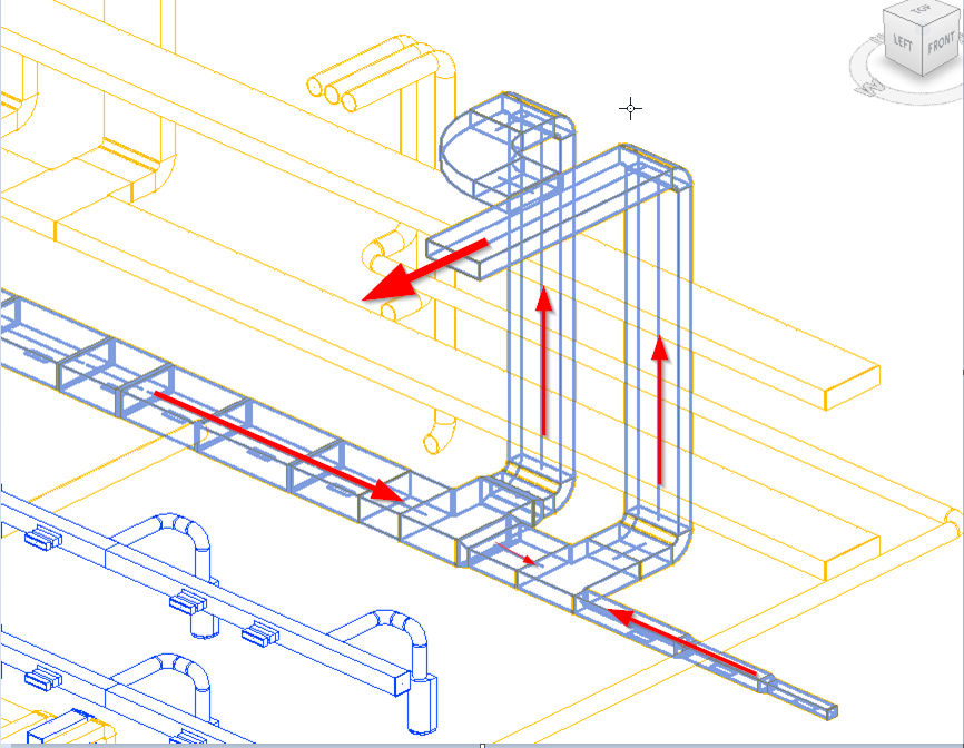

Hi,
I need help/solution how to create ductowrk fitting T where I can limit and control airflow direction. I am using Revit 2015
Please see image where thickness of arrows represent floware as you can see I need in T on left hand side that only part of flowrate to take up and remaining part move to next tee that works as normal  which means merge two flowrate into one
I really hope can find some aswer here,
Michal

I seem to recall a god blog post about this.
Here's a few links . . .
http://thebuildingcoder.typepad.com/files/me204-3_connectors_in_revit_mep_content.pdf
http://forums.autodesk.com/t5/revit-mep/direction-of-pipe-in-a-family/td-p/4313315
http://aectechtalk.wordpress.com/2012/05/29/revit-mep-connectors-misc-information/
http://mep-cad.blogspot.ca/2013/01/getting-in-flow-with-revit-hvac.html
