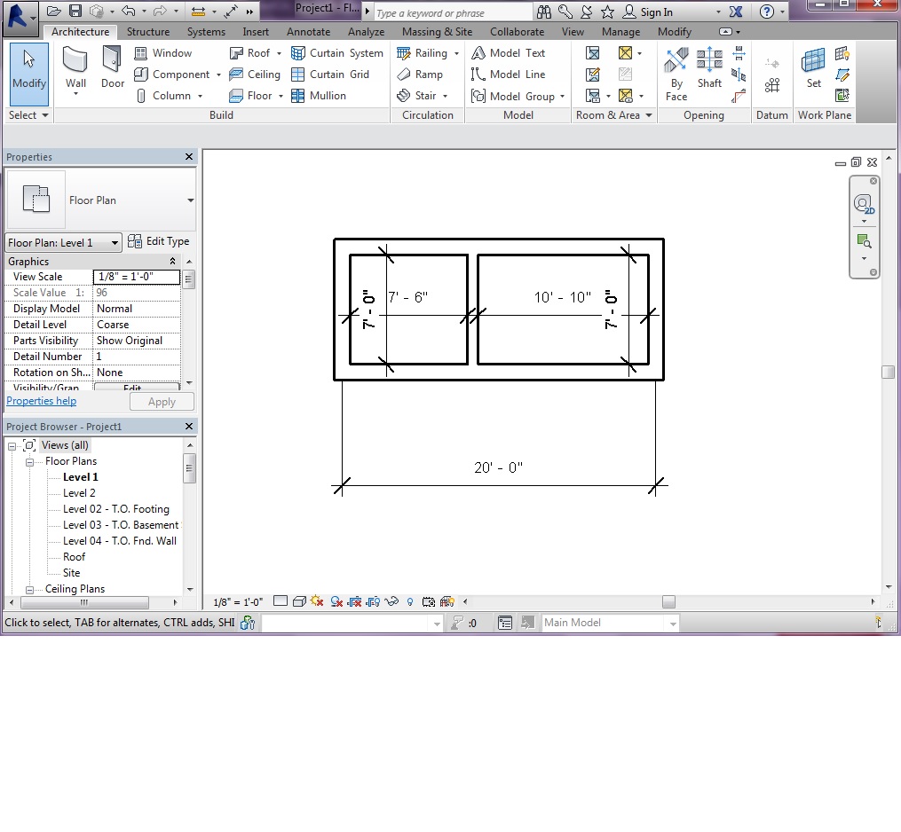

Here is a picture of what is happening to my students.
They would like the room on the left to have a floor dimension of 8x8 and the room on the right to have a floor dimension of 12x8.

Thu, Oct 9, 2014 at 9:44:35 AM | Room Sizes
Click on a wall and change the highlited dimension to what you need.
