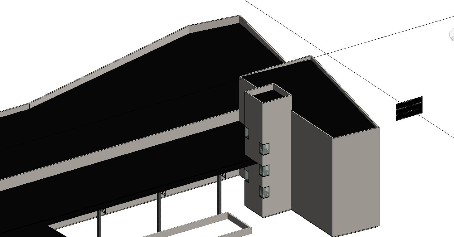

Hi guys,
I have a project that I have to present tomorrow and I am very new to Revit.
I have drawn my sloped roof (by footprint) and all I need to do is apply this metal roofing panel material.
Please help guys, my boss is super picky and I need to present this ASAP!!!
Thanks
Wed, Oct 8, 2014 at 10:37:02 AM | HELP - How do I apply metal roof panel to my existing Roof

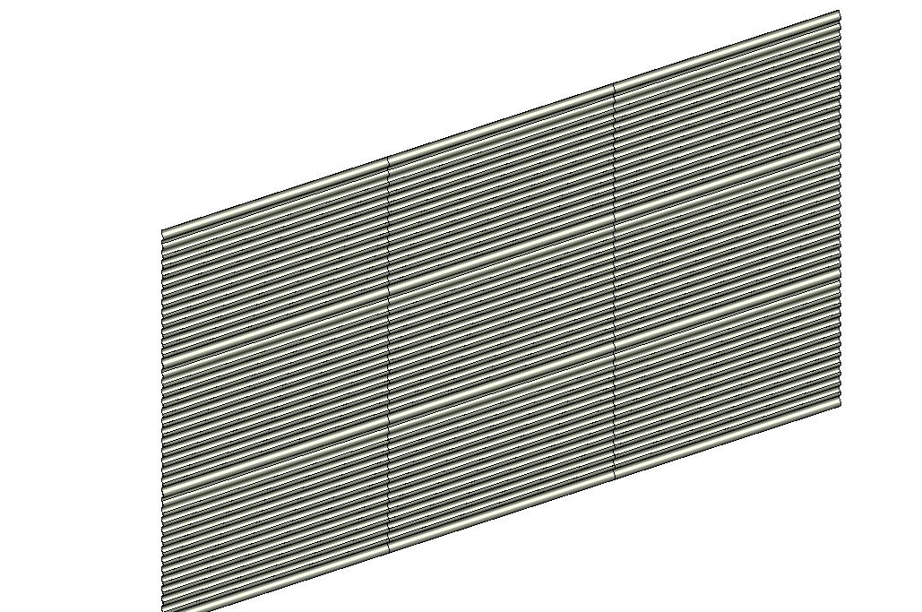

If you already have this as a Revit material thenthis is easy.... Just assign the material to your roof.   The material should have a model hatch associated with it for non-rendered views.  That hatch is tied to the material so that you can rotate the material by rotating the hatch in a 'normal' elevation view.
