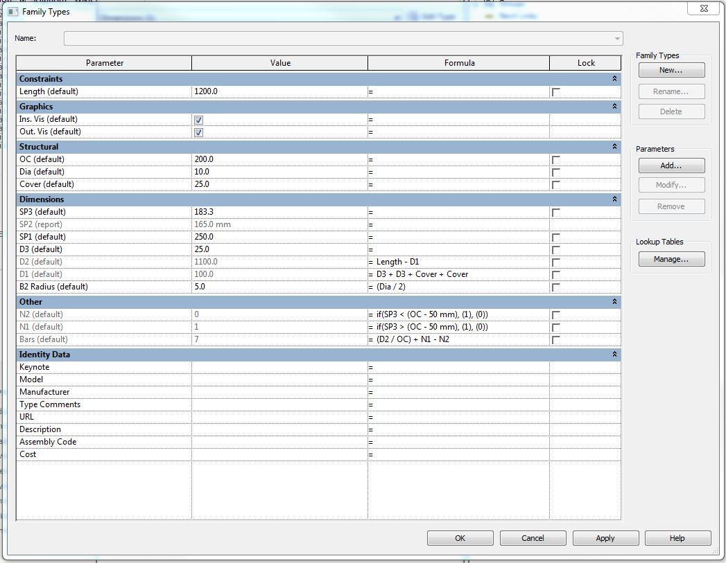

hi. i am trying to create a rebar detail component family. i've got it working to a point when i try and change the spacings (seems to semi work in project but not in the family). what i'd like is a reporting dimension that drives the amount of bars and keeps the spacings in around the OC (off centre) but it throws up the not hosted error message. probalby doing this all wrong but any help appreciated cheers

Are you aware that Revit has built in Rebar detail components?

ye they're not great tho. i'v realised that i cant have a reporting dimension that can be entered into a formula so i made do with "Length / Spacings + 1" number for bars and it seems to work ok. i've attached rfa file
