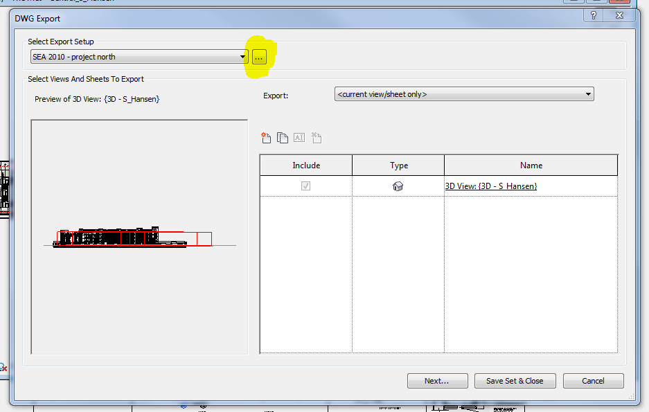

Is it possible to edit a model from revot to rhino? I exported my model from revit to rhino and I seem to have a problem editing it particularly trying to unroll the surface to create a template to card/laser cut it. Nothing gets selected when I try to select a poly surface when trying to unroll a surface in rhino. Is there a method which I can use to edit revit models easily in rhino? Sorry for the trouble, I am not too sure what I am doing since I just started using revit a few days ago.

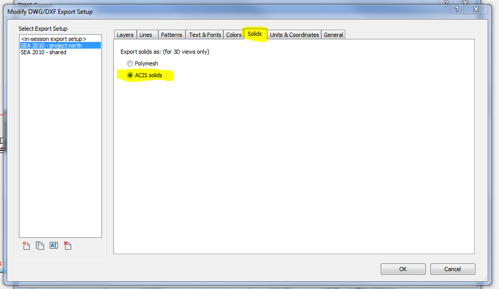

My best guess is that you did not change it to an ACIS Solids when you exported it to Rhion. Check and see if its a Polymesh.
If it is a Polymesh take a look at the picture to change it to ACIS solids model.
Hope this helps
