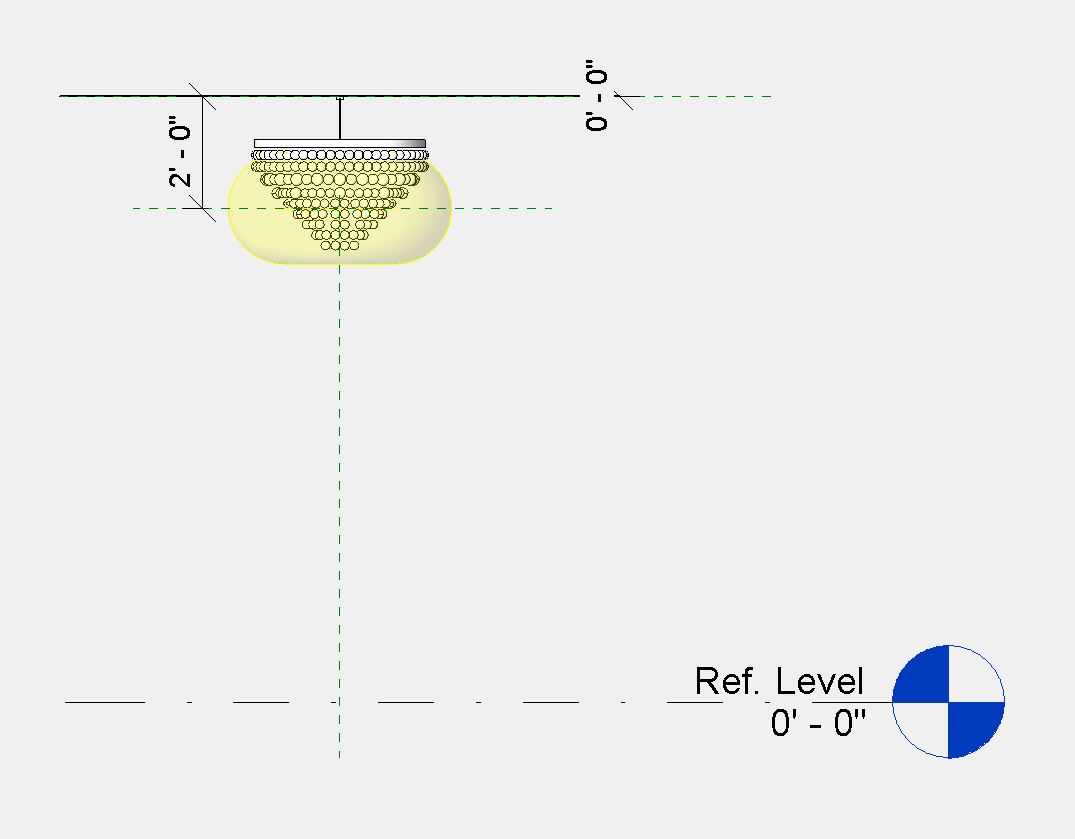

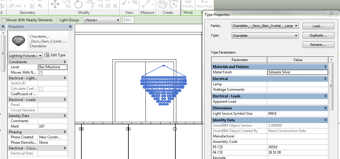

Hi,
I have been trying to put this chandelier into a project i am working on, no trouble getting it into the project and moving it around but I am having trouble adjusting the height at which it sits.
The only place i can seem to see any way to adjust the height offset is to edit the family, however this seems to make no difference when loaded into the project.

Unlock 4’-0” dim and bring down the ceiling – use align tool. If you want to be able to adjust the chandelier height, you need to create a parameter to control its offset from the ceiling (or the floor).

thanks pijpiwo. that works perfectly
