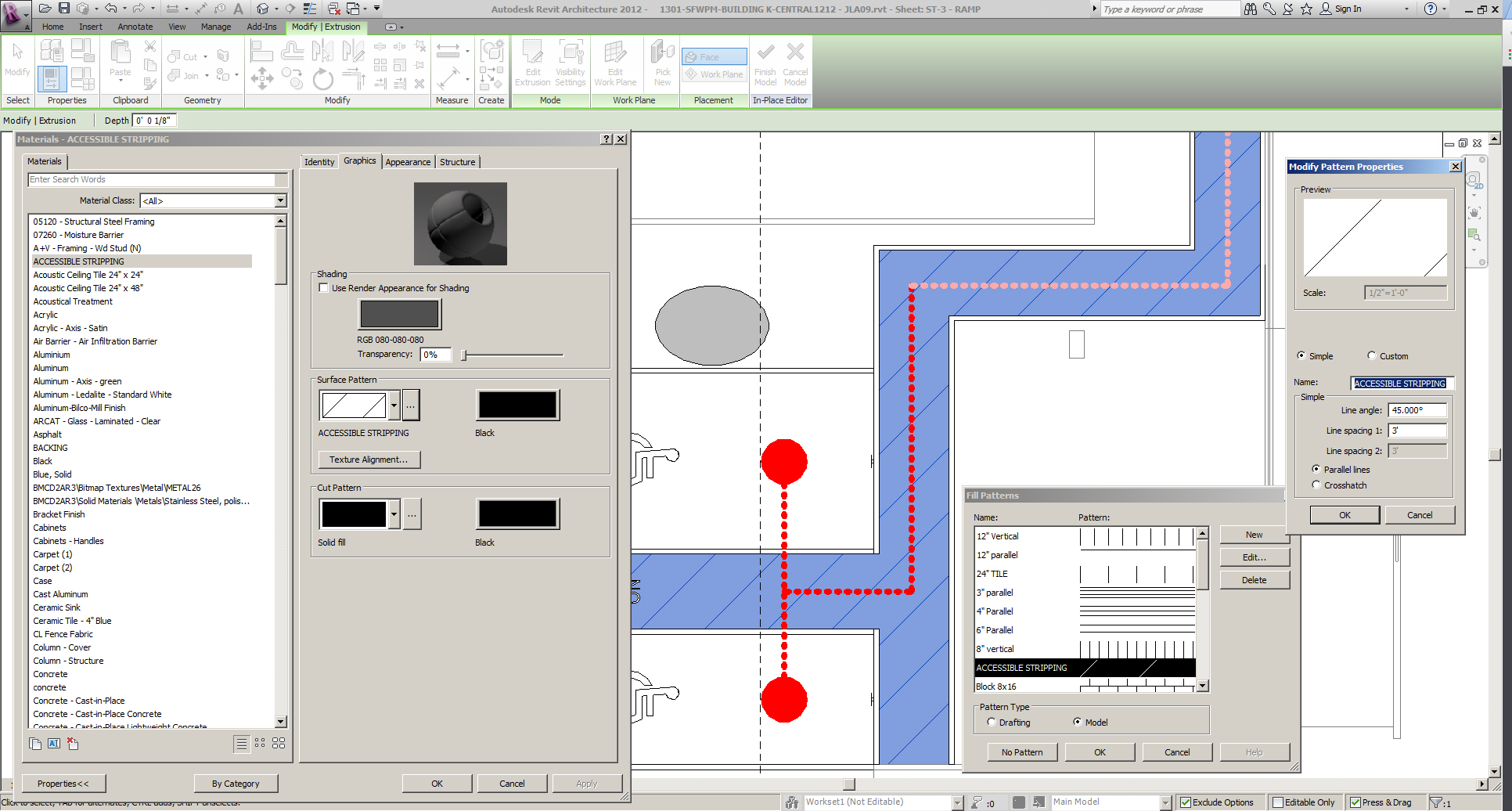

The material pattern for a generic model made of an extrusion shows in the model but not in plan view. Both model and drafting patterns have been tried, there are no overrides and the detail level is set to fine.
Does anyone have an idea how to make the pattern show in plan? Thanks!

Thanks for weighing in, the cut plane is above the object so it should be showing the top surface. Attached is a screen shot of the object material properties.

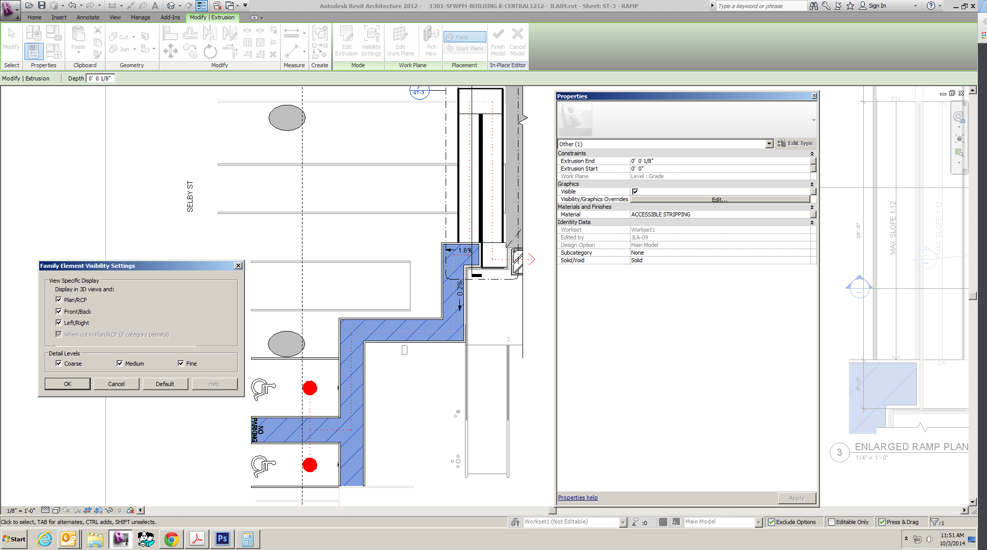

These are the object properties. When in the Edit In Place mode for the object, the pattern shows up but it dissapears again after clicking Finish Model.
