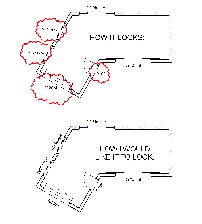

I'm currently working on a project which (in plan view) has standard walls at 90º horizontally & vertically.
This project also has  a section of walls which (in plan view) are at 30º & 60º.
I'm finding that I'm unable to get my door & window codes to sit parallel to these 30º & 60º walls. (see example attached)
Is there a way to get this to work? Or will I need to create a separate family for these codes to use on the angled walls.

In the tag family, check ‘Rotate with Component’ in properties.

Thanks pijpiwo !
Much appreciated
