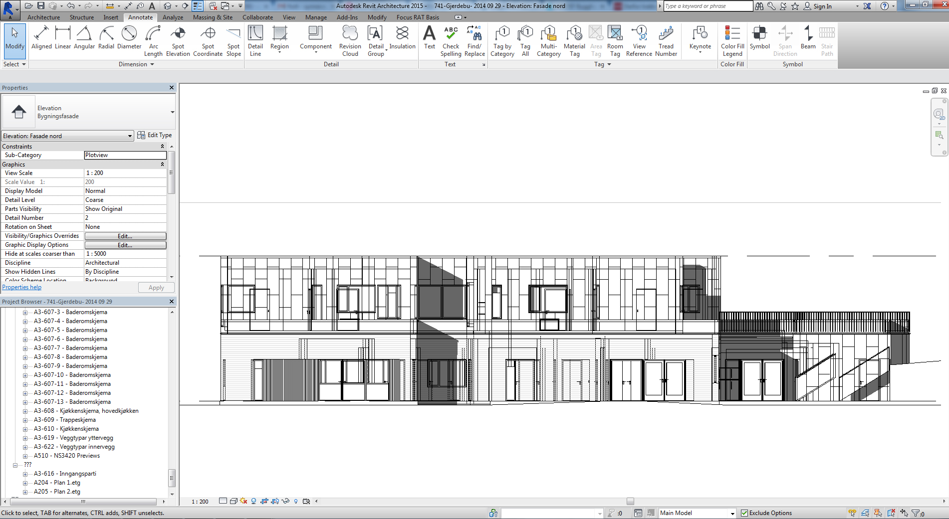

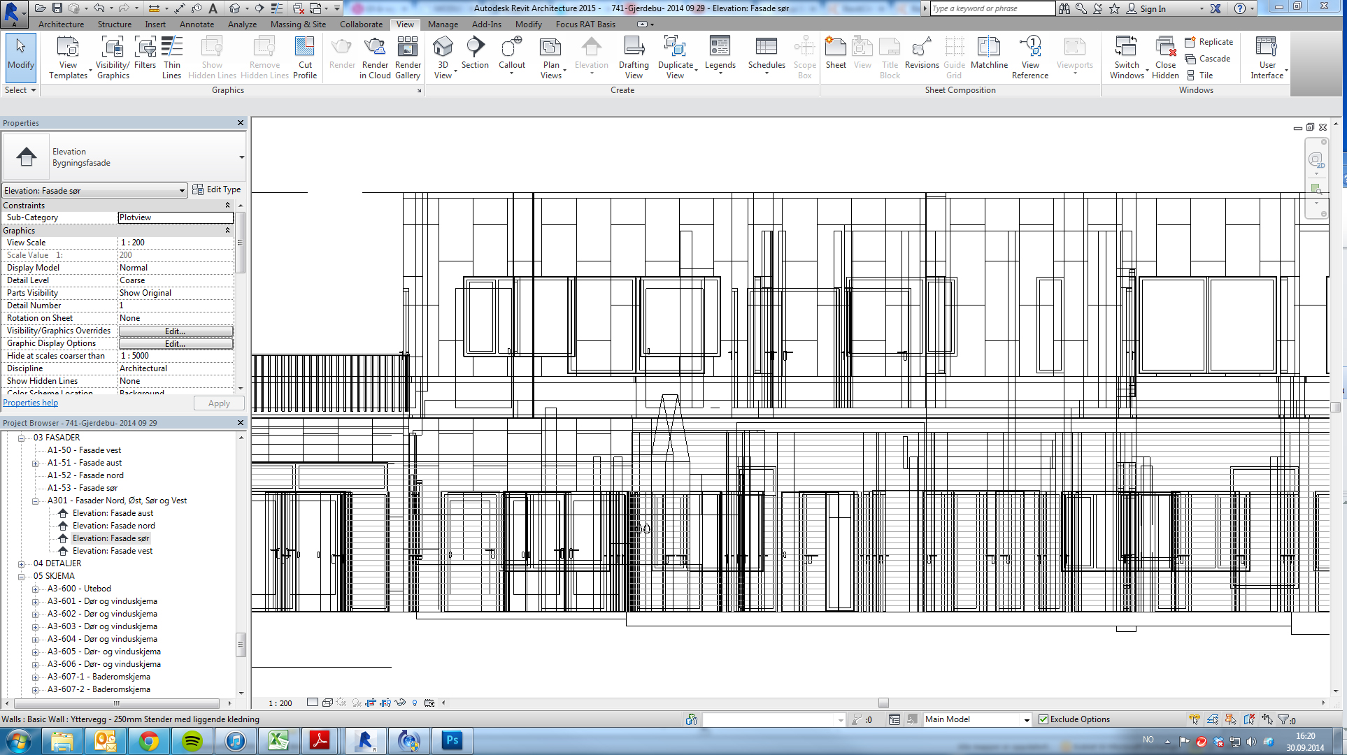

I am having problem with the  facade, section and detail views, they show everything as if the visual style is wireframe, even though it is not. I have been working on the same file for a while and at first it was working as it should, but suddenly the facade, section and detail views started showing like this. When it started I had the 2014 version, now it's updated to 2015 version it's still the same problem with the project.
Projects I've made later works as normal.
Anybody know what to do? Is it possible to fix this?

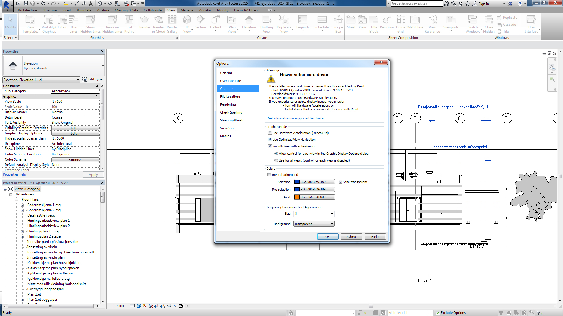

I have not installed the 3 updates, no. I don't think that I have installed a viewtemplate to the views, how can I find out if I have?
The views doesn't change when I switch off the Hardware acceleration. Look at the file attached, could it be likely that I have to install another driver?
Synneva
Tue, Sep 30, 2014 at 9:07:48 AM | Elevation showing everything
That image shows you don't have a template and that it is not set to wireframe.
BUT - Are you sure your looking at a wireframe view?  I don't think so.  Switch the setting to wireframe and see if it changes to even more objects showing.  If that is the case then you have something else going on.   Hidden walls or some objects over-ridden to transparent or even whole categories set to transparent in VG.

Wireframe view showes more than the other views. I can't find that something is changed in the VG settings that should make the views like that. When the views in Revit started to show like this, it happened in both my computer and my colleague's computer, even though we don't work at the same files. When we start new projects, there is no problems with this.

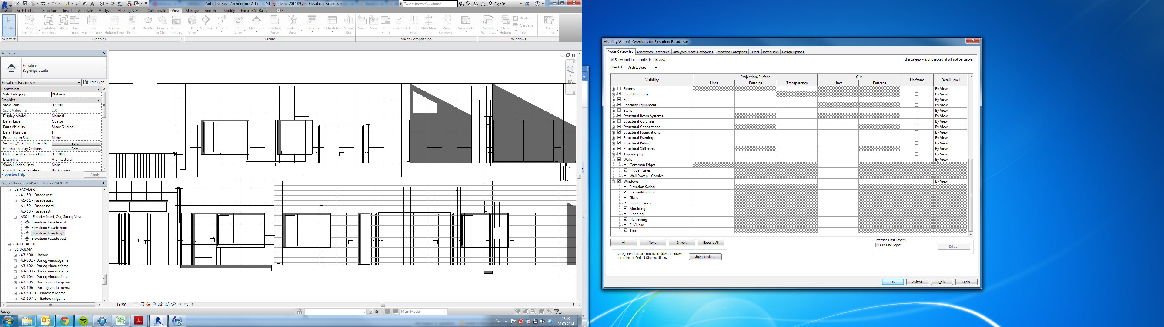

the fix is that you probably have some linked autocad files thats corrupting the views...what you should do is to go to the affected views and turn on visibility graphics - under 'imported category' tab, turn off or uncheck 'Show imported categories in this view' - thats what i did and it fixed it. repeat for other affected views.
