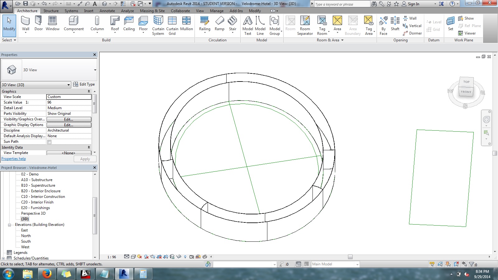

Two problems:
I want to have the wall I've created with a mass to be cut where the horizontal walls pass through.
I want a sloped wall with the low point being the North and South ends.
Solutions?
Tue, Sep 30, 2014 at 7:01:36 AM | Sloped Curved Wall & Cutting Wall
Walls by face have limitations.  That is why you are always better off to use regular walls if you can.
I think you will have to edit your mass and place a void where you need the wall cut.
