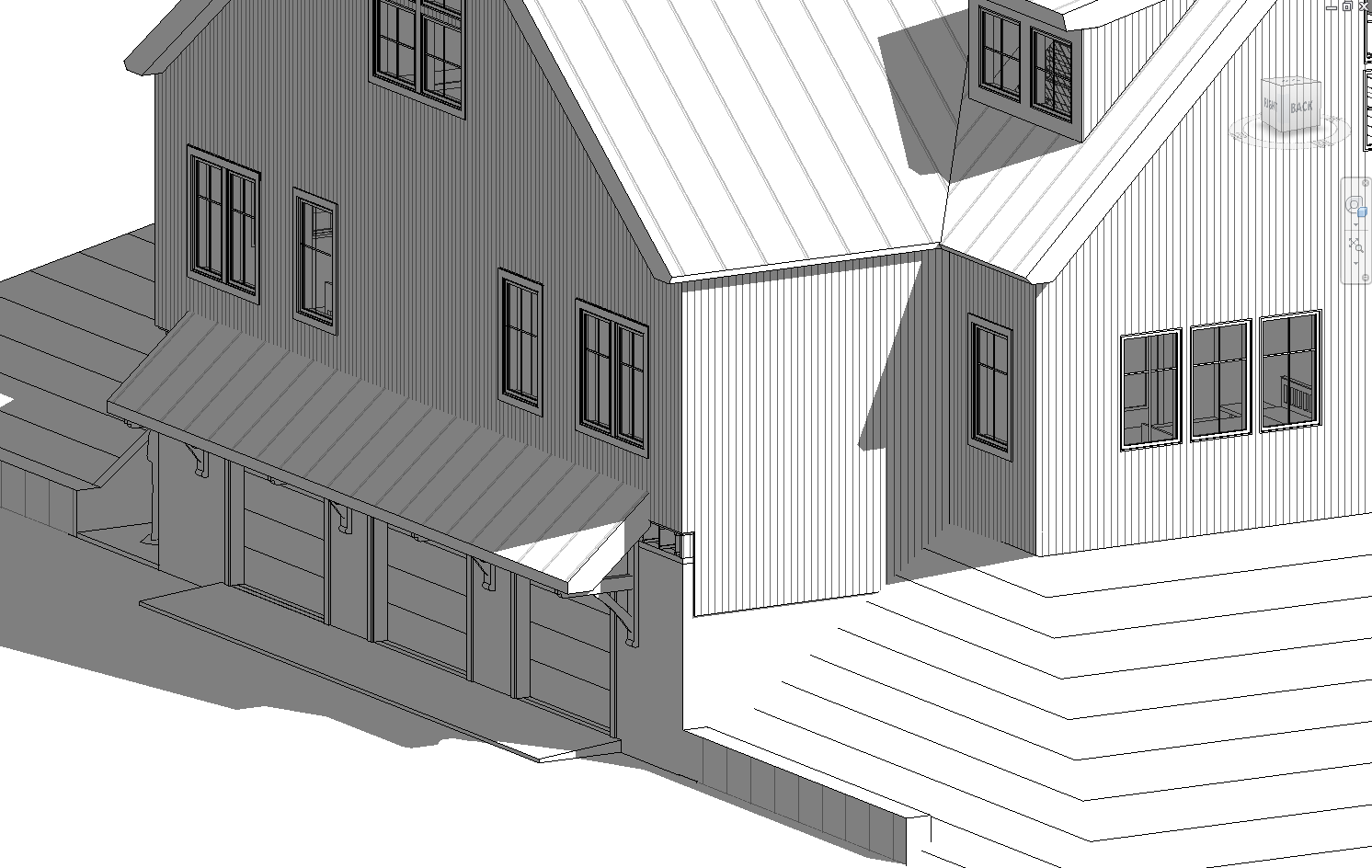

I modified a standard wall sheathing to be able to extend it over the floor edge and the basement wall to grade. can I adjust the profile of this layer only to allow for openings and stepping?
Tue, Sep 23, 2014 at 8:45:35 AM | Modified wall layers (Sheating) need cutouts for openings and extensions
The layer will not step independent of the wall.  If you need the stepping, then split your original wall vertically and adjust the layer independently. If this is overly coplicated then maybe you need a thin wall with an edited profile.
All vertical wall splits can be joined in elevation views so there is no vertical line.
