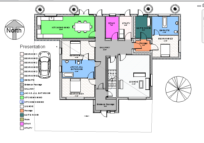

Hi, I have made floor plans and did color scheme to my plans, but when i bring legend on curse, it brings the whole list of rooms in list for example if i did all bedrooms with red color, rather than showing bedroom indicates red, it shows bedroom1=red...bedroom2=red etc, i will attach pic for ref, hope anybody can help

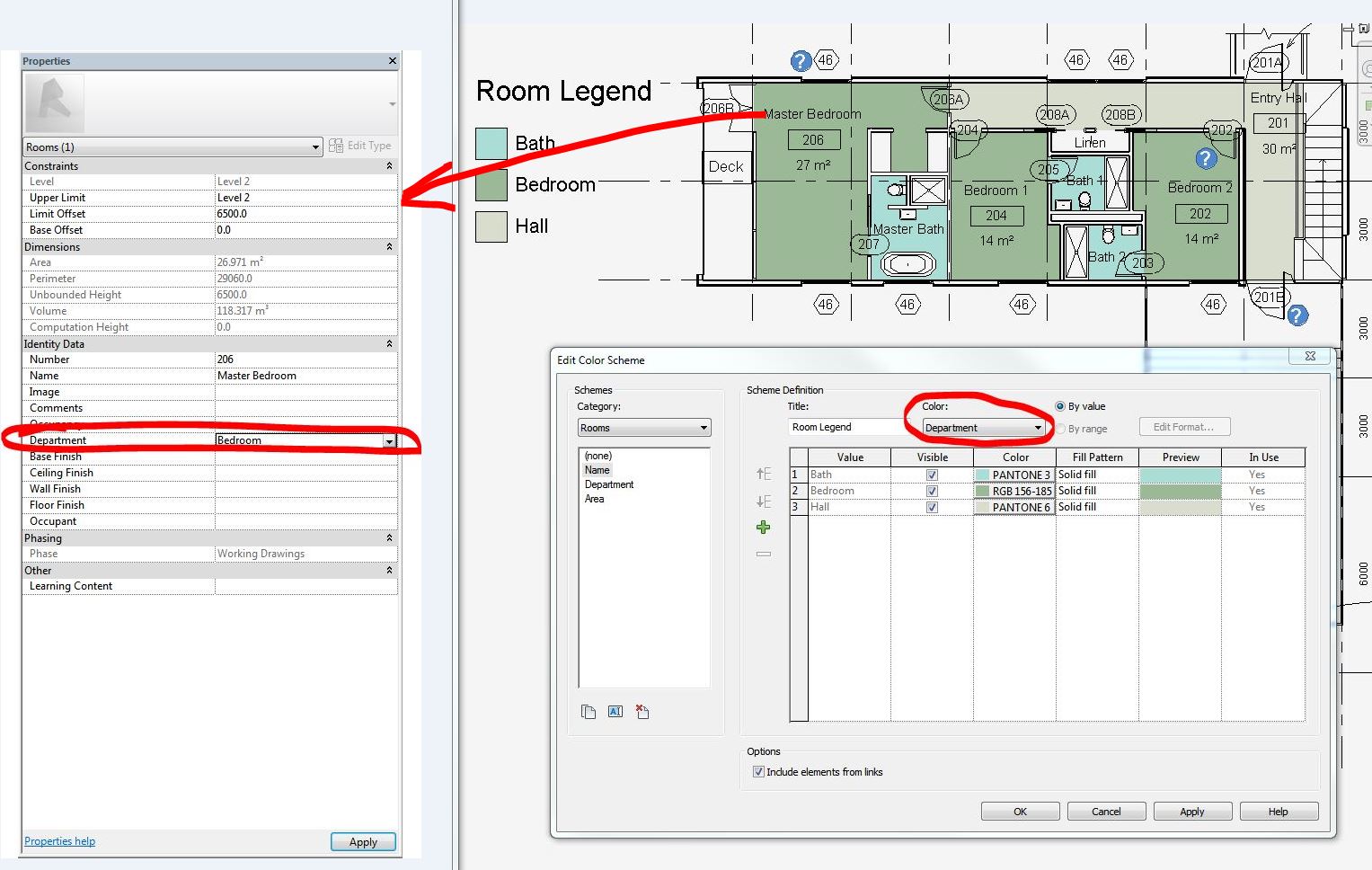

It’s because you have your scheme definition color set by name. Change all bedrooms name to ‘Bedroom’, or if you want to keep the current naming, use color by ‘Department’ let’s say, and fill in ‘Department’ parameter field for each room in its properties.

Thanks for your reply mate, It did worked out when i did all bedroom names identical, but if i go for bath room, in plan i got JACK & JILL BATHROOM, Bathroom, En-Suite..but in color legend i just wanna show blue color for all or any type of bathroom, how it will work?

Make color scheme by department and in the room properties under Department parameter, fill in with names like ‘Bedroom’ for all bedrooms, ‘Bath’ for all bathrooms, etc.
