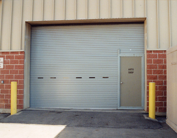

Does anyone know of a overhead door manufacturer that has download for OHD famlily that a man door hosted to it?  This is typical a special order so there is not much out there on the net.
How does one host a man door to an OHD?  This project is a documentaiton of existing condition project so there is no scheduling to be done later.
Thu, Sep 18, 2014 at 11:08:37 AM | 2014 Arch: Man Access door hosted to an Overhead Door
That door does not appear to be a part of the OH door .  The OH door has been cut fit around it - correct?
I would probably edit the OH door family and cut the hole in it.  You could edit the opening cut in the family and put a shaped void in to cut the opening.  But I would probably add a short wall in the opening to host the man door.
