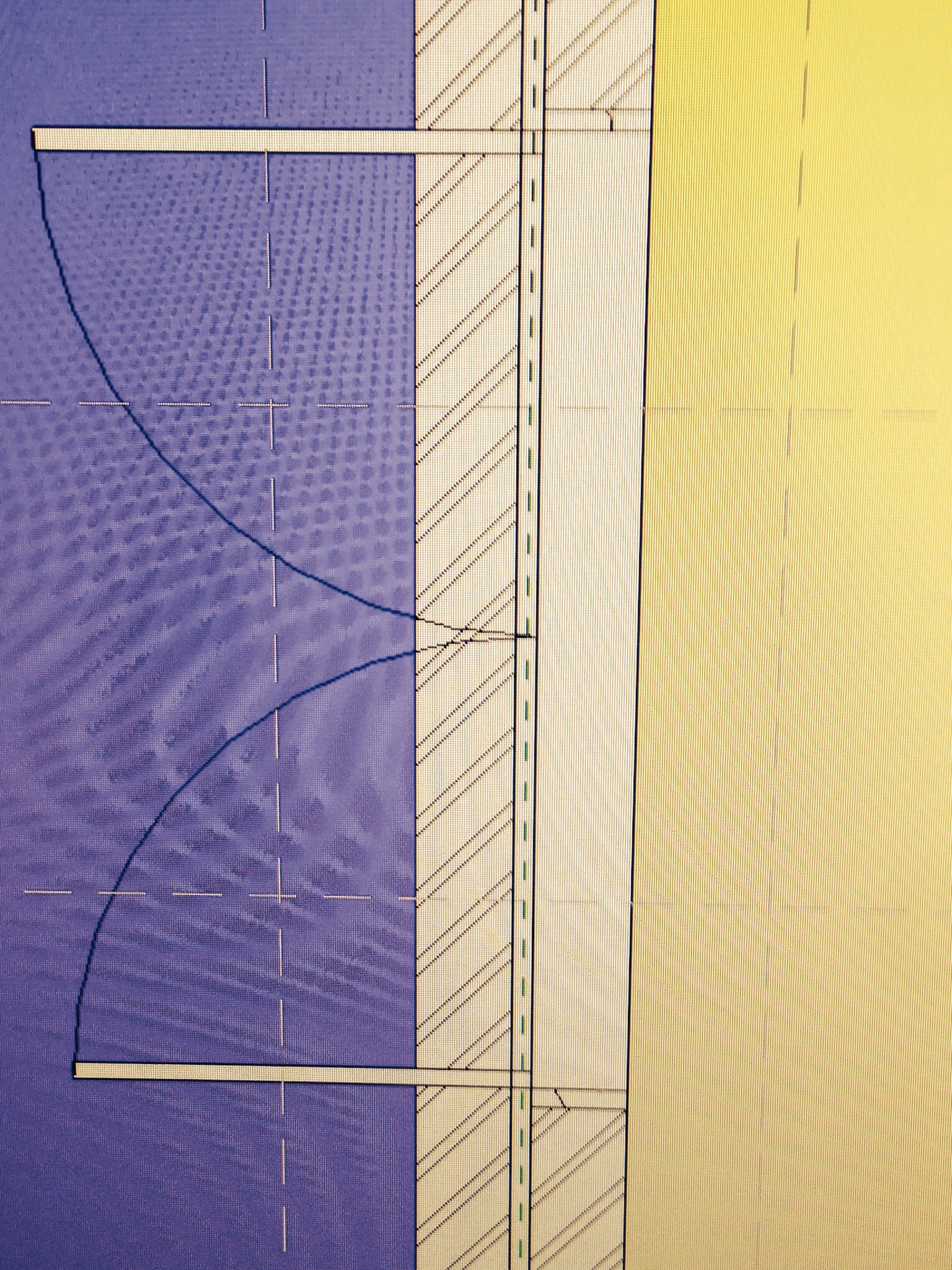

Once I insert my door as shown it cut only one wall, What is the way to cut the another one. Any one know....

Use Join from the modify ribbon on the 2 walls, and the opening will cut both walls.

Perfect, it work, thanks for you
