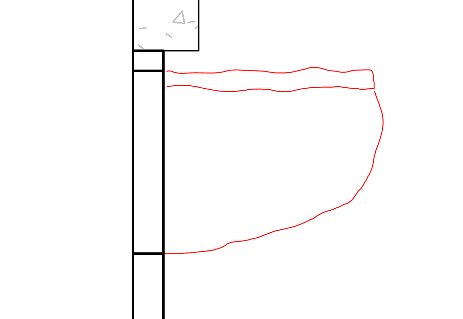

I am doing a new building in my office. I have put up all the walls and everything and am placing doors now. For some reason my doors are not showing up in plan. The space is in wall, but the door swing is not there with the door. I have checked my families of all my doors and the drawings are there and are set to show for plan. I have checked phasing and that is correct. I have checked cut plan and that's correct. Visibility Graphics is correct. And it's not hidden in the view. Does anyone have any idea as to why this could be happening or how to fix it?

Open a brand new project with OOTB template and insert your door. If the same, there must be something wrong with the family. Can you upload your door family so we can take a look?

Well I figured it out. Someone accidentally, or so I hope, went in after I did and made the view range 1000'-0"... Some people just need to pay attention to what they are doing. Thank you for the help
