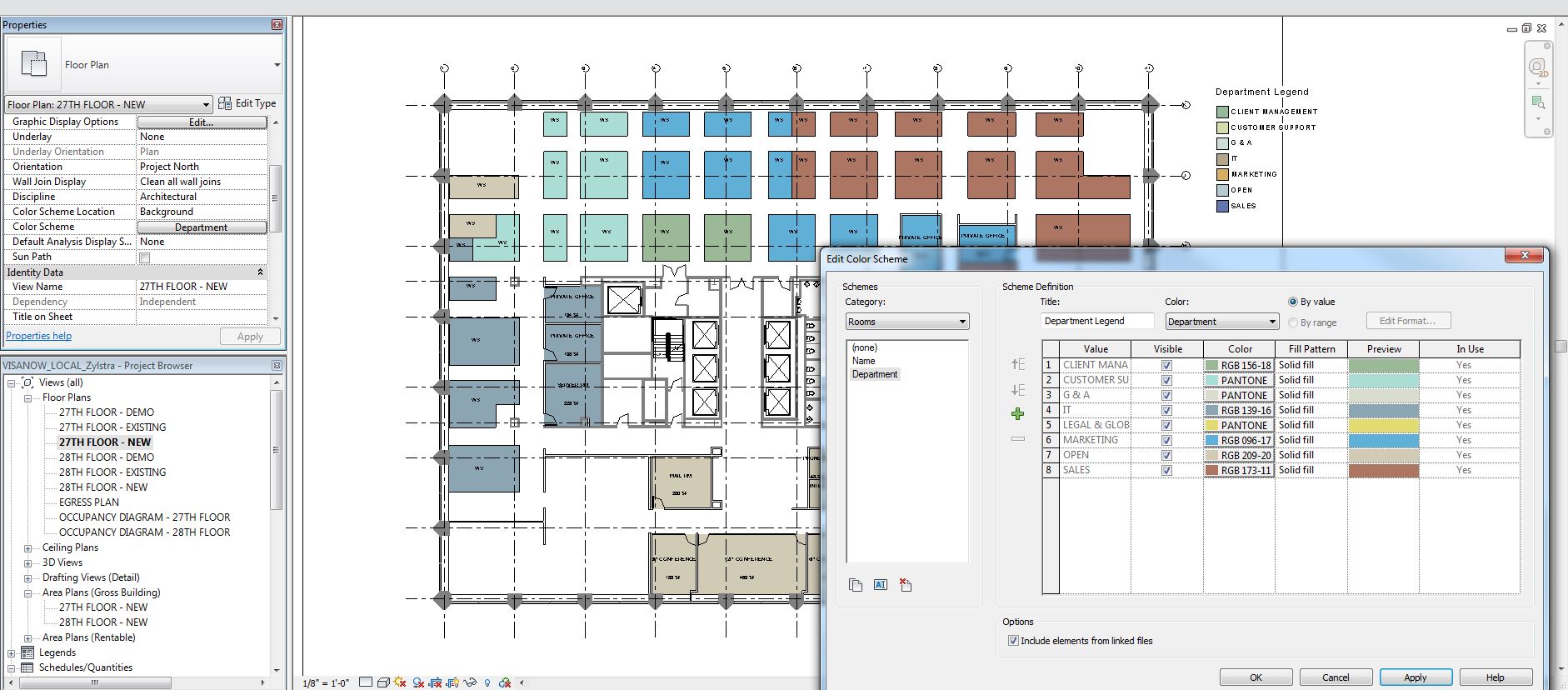

I have created a Department color scheme linked to the Rooms.
When I change the colors in the dialogue box they change in the plan but don't change in the legend. This is really frustrating rendering color schemes un-usable.
See attached image.
If anyone has any advice let me know. I have used a lot of differenrt versions of revit and have not run into this problem.

Right in the help file:
If the color fill legend that displays does not reflect the color scheme that you want to use, do the following:
  1. In the drawing area, select the legend.
  2. Click Modify Color Fill Legends tabScheme panelEdit Scheme.
  3. In the Edit Color Scheme dialog, select a different color scheme from the list, and click OK.
    You can also create a new color scheme in this dialog. For more information, seeCreating a Color Scheme.
*just noticed you said it was Revit 2012, don't know if this also works in that version*

Thank you for the reply. I think it might be a bug with 2012. The colors don't even match in the ledgend from the get go. A room will be yellow and the ledgend shows green.
This person had the same problem but never had any responses.
http://www.revitcity.com/forums.php?action=viewthread&thread_id=29756
Let me know if anyone has a fix?
