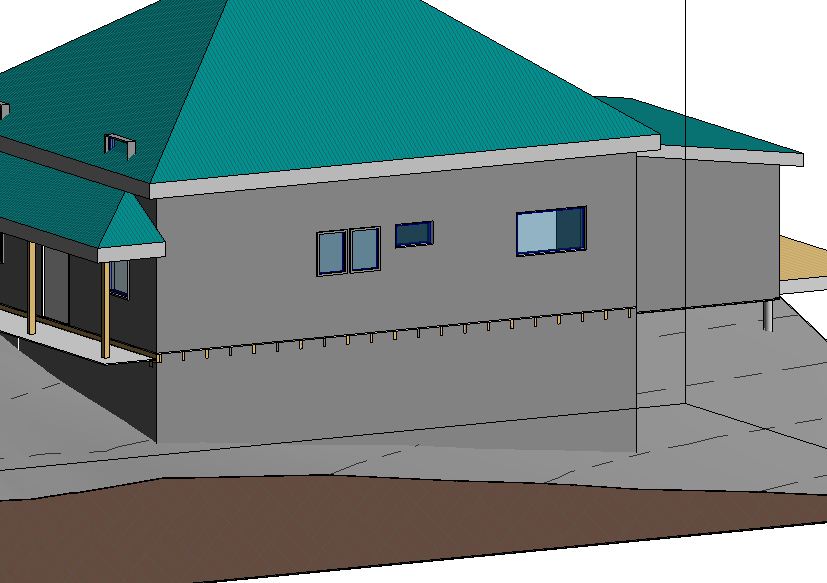

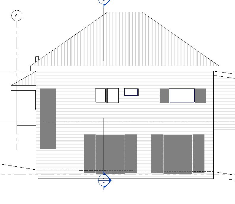

Calling for help from Revit pros out there..
I've got a querry on Phasing from a colleague. Basically, all new constructed opening cuts are showing in existing elevation with [show complete] filter setting. It looked totally fine in the 3D views when I apply the same phasing and phase filter. What we are wanting to achieve is to show ONLY existing components in the view when we apply [ Phase : Existing and Phase Filter : Show Complete]
Does anyone know what is wrong and how to fix this?
ps: I've attached a few snapshots for your reference\
Thanks heaps in advance!
134188_1407-elevation.JPG134188_1407-phasing.JPG134188_1407-3D_with_the_same_phasing_applied.JPG

Opening cuts can not be phased, they will always adopt the phase of their host, select it and see its phase properties is greyed. Often a better solution is to use a door or window family, with just the opening cut in it, then it can be phased and scheduled.
