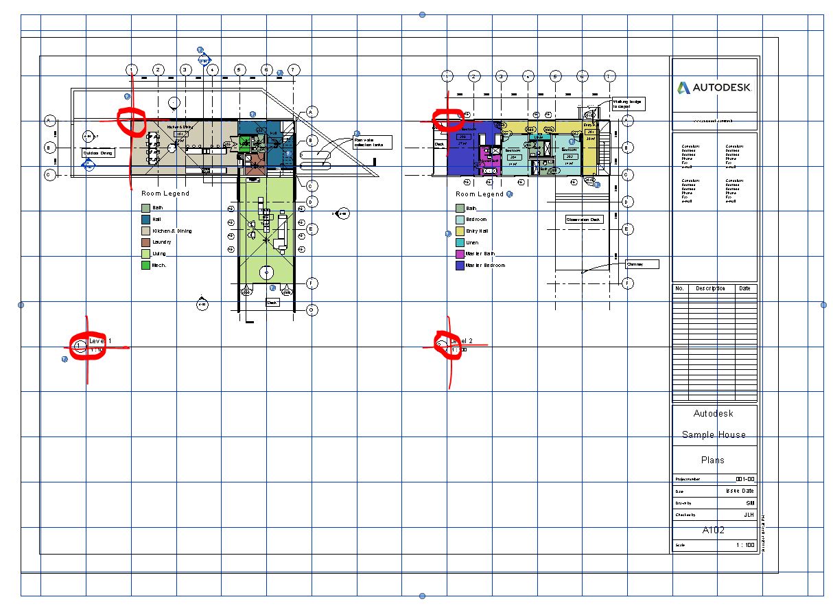

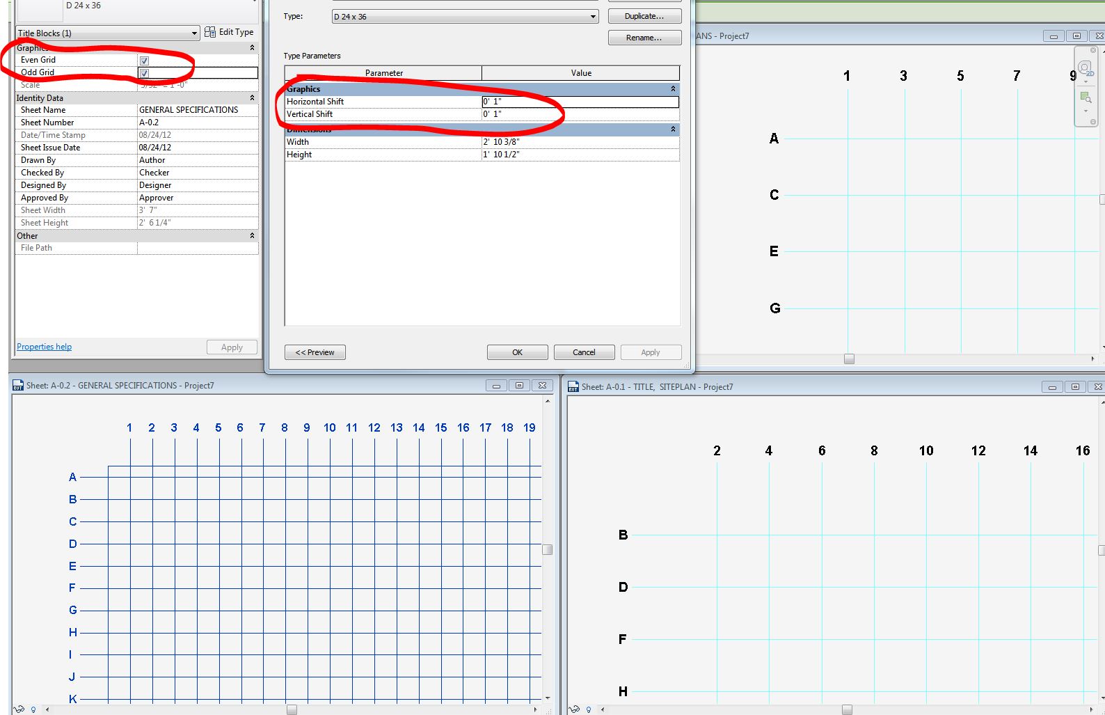

Mon, Sep 22, 2014 at 6:56:41 PM | WWHub
#10
pijpiwo
pijpiwo Avatar
Joined: Fri, Sep 3, 2010
0 Posts
5 Stars: 25 Votes
Quoting WWHub from 2014-09-12 09:45:43
The family could have invisible lines that only work when you roll over them or it could be visible lines that you turn on/off or swap the whole family out for a plain one.
So, I made a grid in the title block family as per WW suggestion, and I love it! Finally I was able to mark the grid so the grid line intersections can be identified. Also, I made visibility parameters for even and odd lines if the grid is too busy, and vertical and horizontal shift type parameters to be able to move my grid around if needed.
Thanks WW for the inspiration Smile
