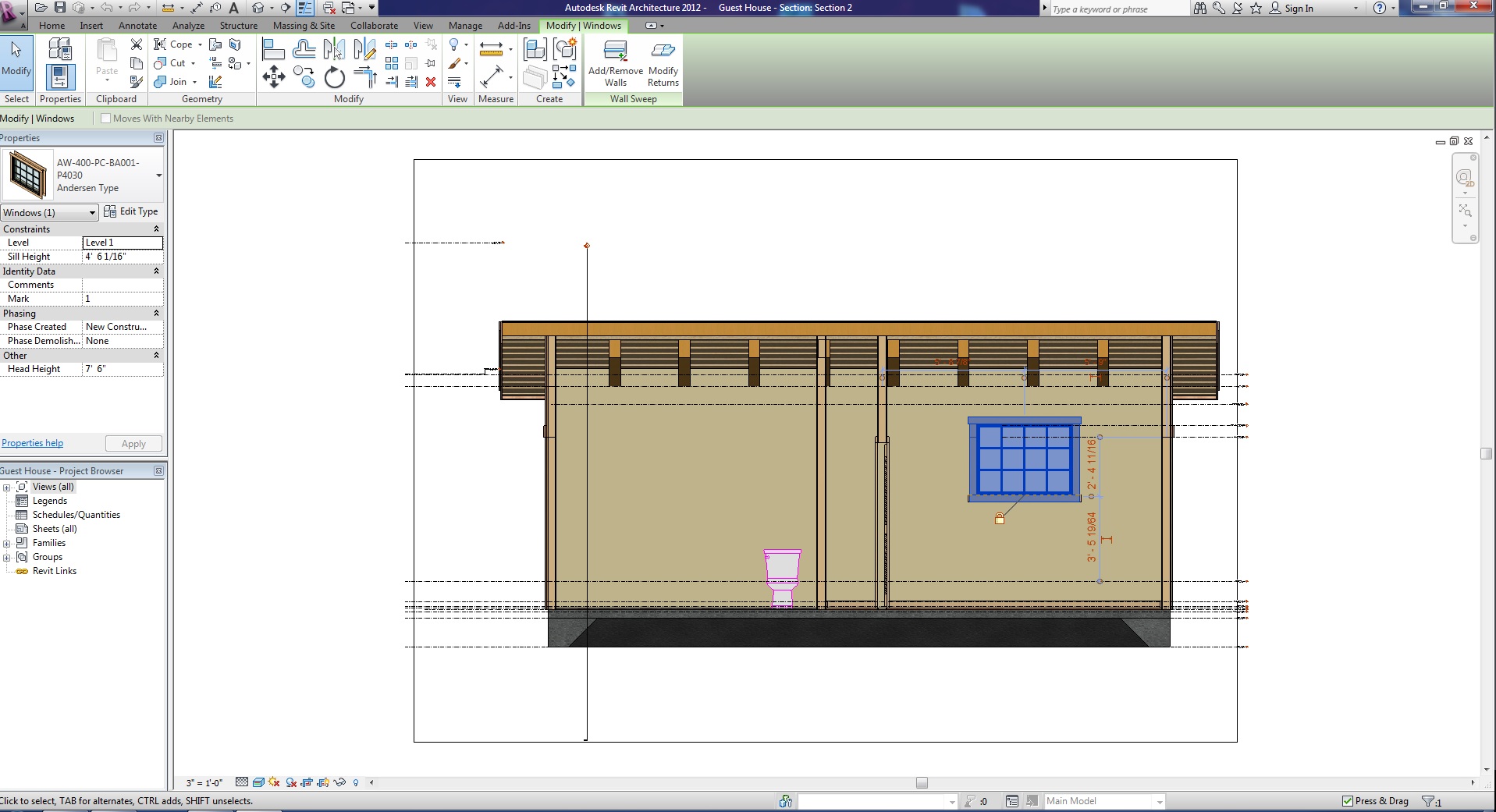

Hi all! I've attached a photo to show you what's going on with my tool bars. For some reason, at some point yesterday while I was doing some practice on a project, my Tool Bars decided that they didn't want to pop up with the necessary tools right away until I completely cycled through them with the triangle cycle selection button. In the attached photo, you will see that I have selected a window and the modify options are regarding sweeps and not "edit family." I've already located and deleted the .dat file that is recommended for resetting this type of issue. No change in the behavior of the tool bars. At this point, I'll have to hit cycle throught the layout options of the tool bar until I get the edit family modify option up and then once I'm ready to do all that, then I have to cycle through again and again and again just to be able to do what I need to do in order to edit things. It's really annoying at this point and things are taking twice as long for me now. I'm out of ideas of what it can be and I can't find anything else online that will help. If anyone knows how to fix this issue, I'd be grateful for the information.

What Revit, what updates?

Sorry... I had looked for the option of how to delete this post because I ended up getting it to work. I had to remove MS .Net 4.5 and download/install .NET 4.0.
