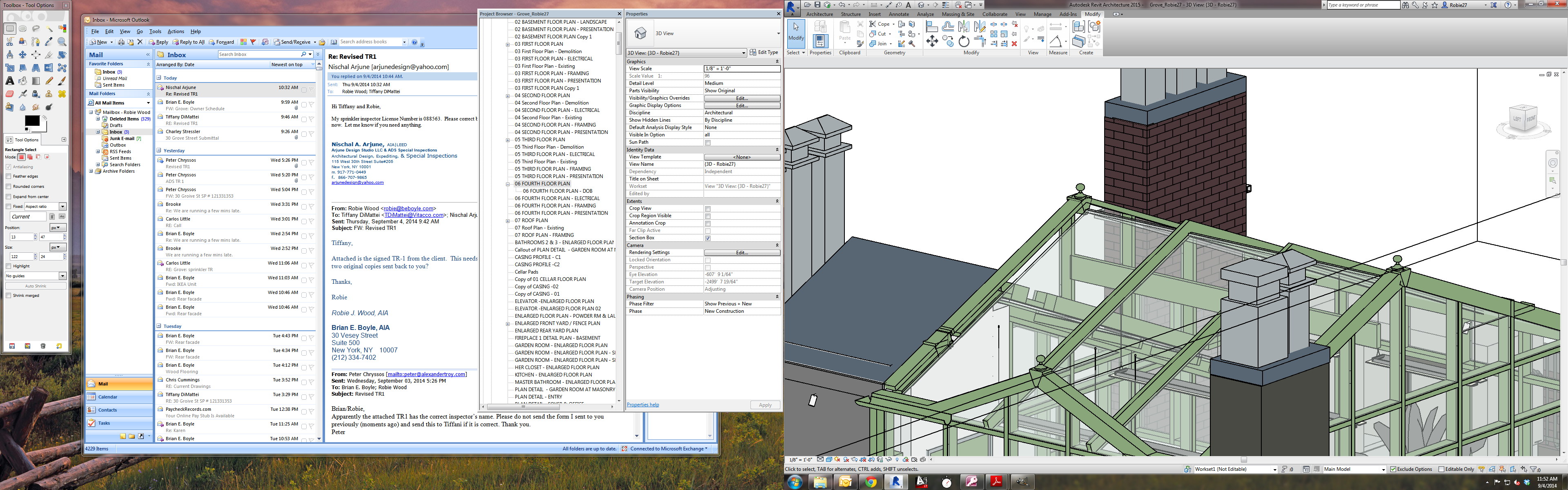

Hi,
Trying to create glass roof with mullions in Revit 2015.  I'm having a problem joining two of the roofs together.  Does the join roof function not work with glass roofs?

Your image doesn't tell us anything really.  show us your roofs

Actually I think I figured it out.  I made both roof as regular solid roofs.  I joined them and then changed them to sloped glazing and it worked.  Not sure why but it did. Thanks!
