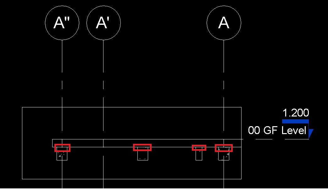

If I m taking section along beam with slab its not showing me section with monolithic construction
it gives me section with beam as full square and slab is with full rectangle.
refer below image.(1.jgg)
in this line which marks with red box should not come.

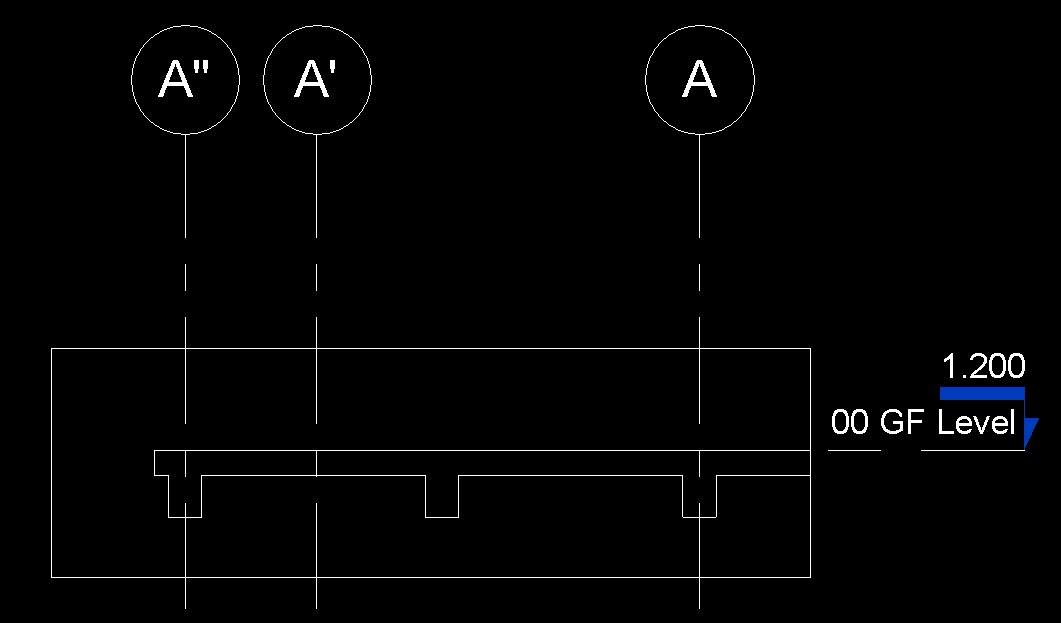

which setting is thr so that I will get my sect monoloithic like shown in image (2.jpg)

Make sure your beams and slab have the same material assigned to them.
