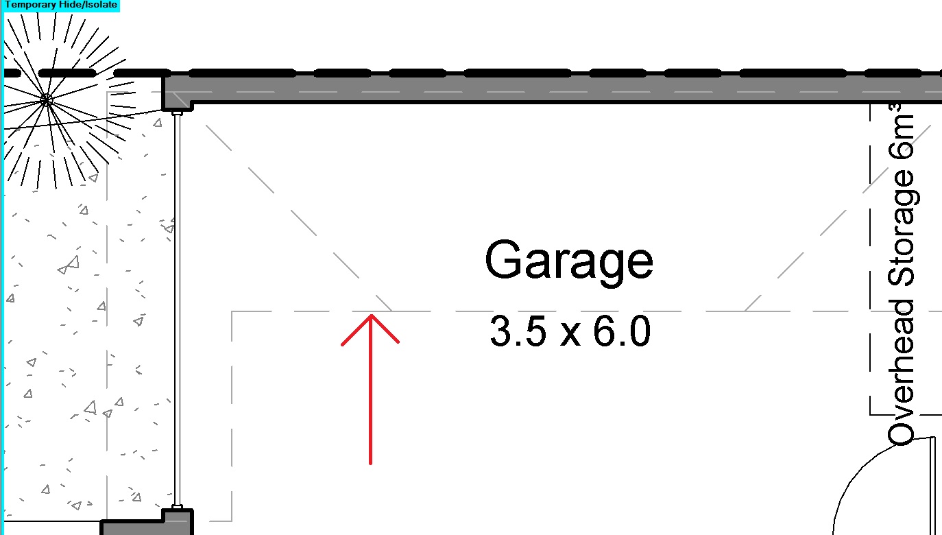

Hey guys, you know how when you show the roof above it is in halftone (grey) is there a way to change it to black to print better? I tried to over ride it in view but doesnt work...any suggestions? Cheers.

Sounds like the linetype you are using for "above" is set to a grey color.
manage -> Additional Settings -> Line styles
look for one that fits the bill... perhaps it's "<Overhead>".  change the line color to black.

I changed everything to black and they were still grey anything to do with halftone or anything?

`halftone / underlay did the trick. Thanks for leading me to the right area
