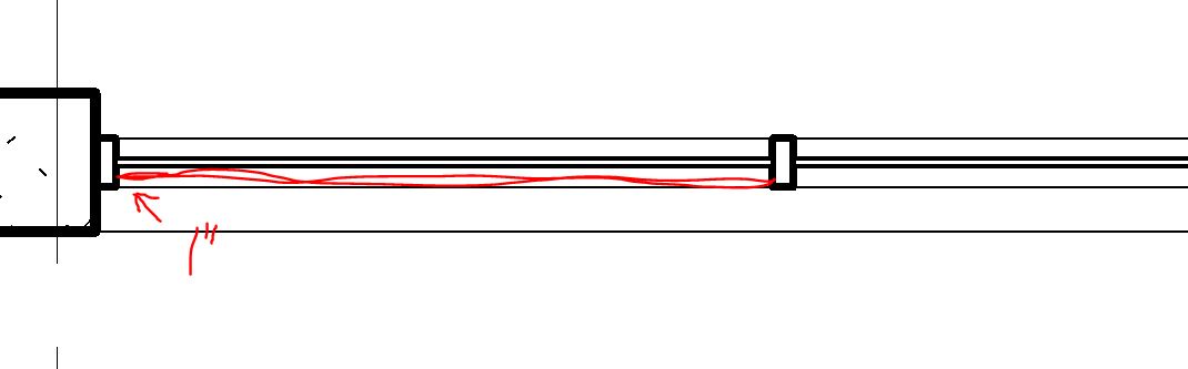

I have looked and can't find in the help files where the option is to adjust the curtain panel from the center line of the curtain wall. so the panel is just 1" set in from the face of the panel system. can someone point me in the right direction please?
thanks a lot

Tab to select a panel -> edit type -> set required offset under constraints
