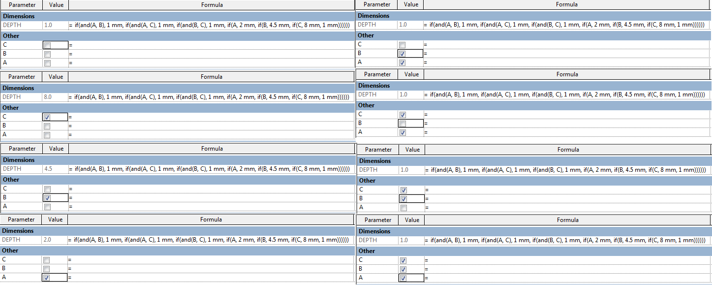

I'm trying to create a condition in a family where a dimension changes depending on which Yes/No parameter is checked. Here's an example of what I want to do:
Let's say I have a wall-based family of a wall-mounted panel. I have a length type parameter that measures how far the panel projects from the face of the wall it's hosted to. Let's call this parameter "Depth". I then have three Yes/No parameters called "A", "B", and "C".
I want to make a formula for the "Depth" parameter that creates the following condition:
If only "A" is checked, then "Depth" = 2". If only "B" is checked, then "Depth" = 4.5". If only "C" is checked, then "Depth" = 8". In any other condition (meaning if none are checked or if more than one are checked), then "Depth" = 1".
Is it possible to create this condition in Revit?

hi  =)
try and derive from this:
if(and(A, B), 1 mm, if(and(A, C), 1 mm, if(and(B, C), 1 mm, if(A, 2 mm, if(B, 4.5 mm, if(C, 8 mm, 1 mm))))))

Beautiful!! That worked!!! Thank you very much!!!
I've been having such a hard time getting used to the syntax of formulas, especially when I'm trying to get multiple values like in this situation.
