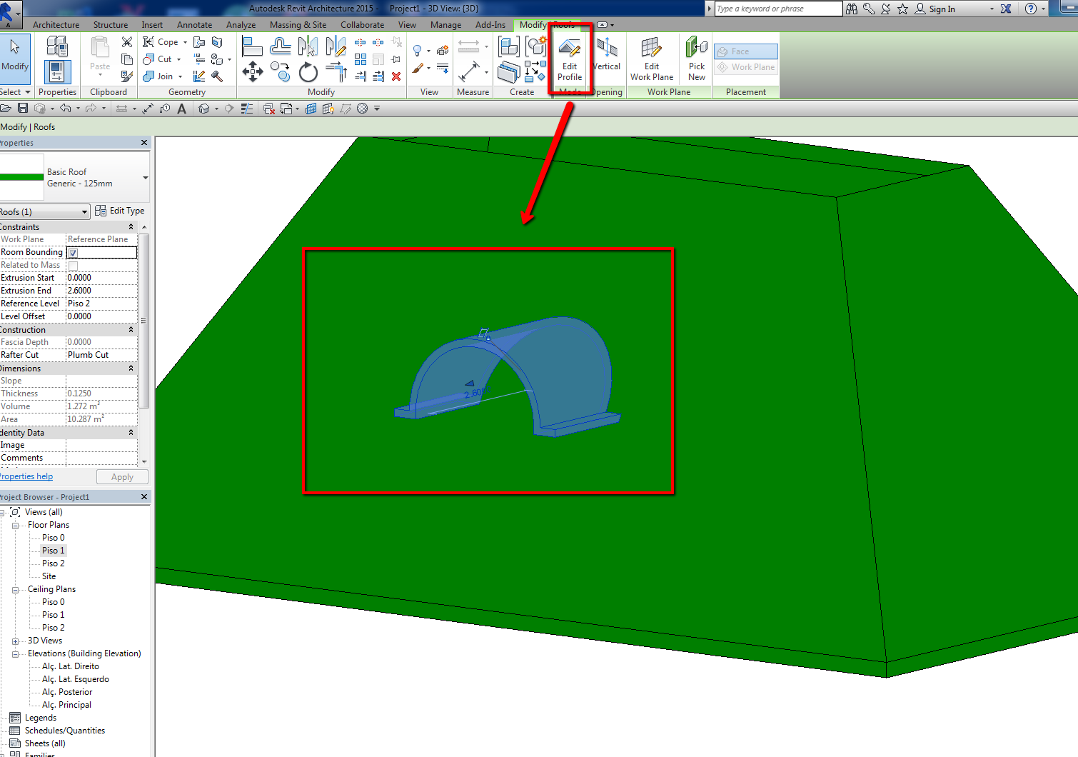

"curved mansard" - Roof by Extrusion
Edited on: Thu, Aug 28, 2014 at 3:34:56 AM
