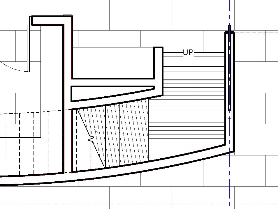

I have created a stair with irregular geometry that has a 3" parallel model pattern on it to represent a wood floor. However, I seem to be unable to rotate or align this pattern and as you can see from the attached screenshot, the pattern is not coming in parallel to the stair treads.
Is there any way to control the orientation or surface patterns when the material is applied to a stair tread?

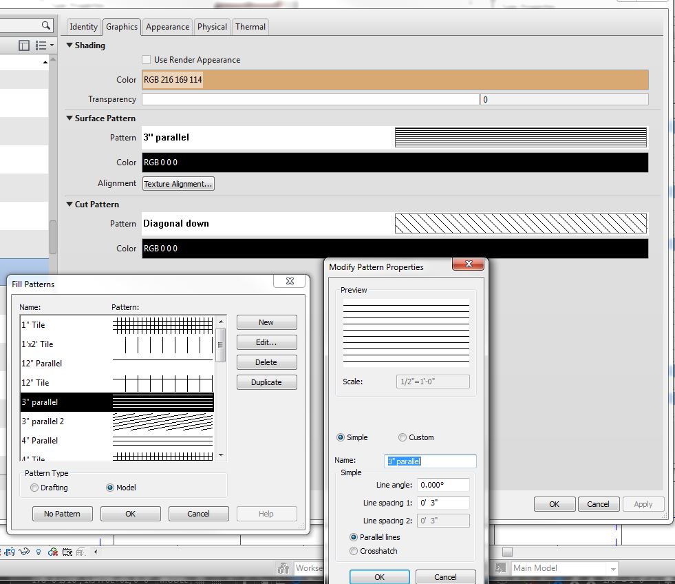

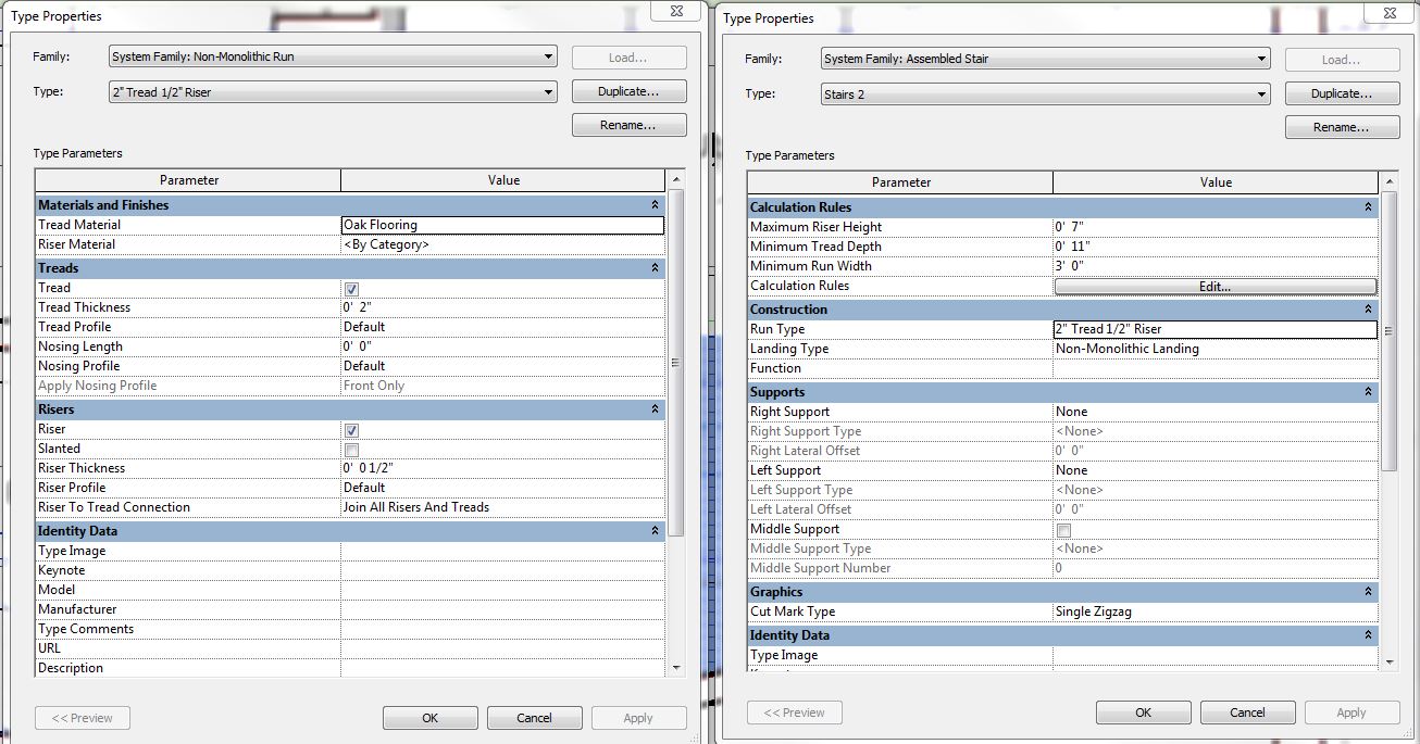

oneworld, thanks for offering to help. I've attached screenshots showing the settings. Because the pattern is just parallel lines it doesn't show up in the .pat file but the attached screenshots show both the properties for the stair and the material/pattern attributes for material that's assigned to the treads.
I'm curious to see if the problem occurs for you as well.

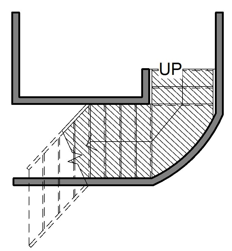

Now I completely understand your issue. I guess mine was a vague suggestion before. Sorry about that. So revit is considering the whole stair to have one pattern. This is what I acheived till now. I will think about this on my way back home. Interesting .. good that I have time now so I don't have to worry later when I face the issue.

Your only solution for now may be two seperate stair runs.
