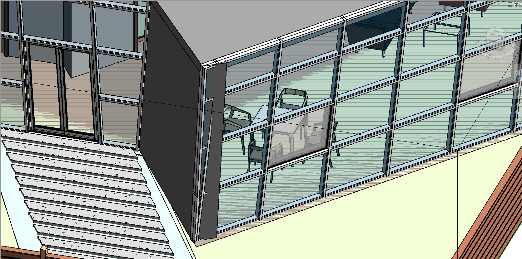

hello everyone. I have made a mass and then wall by face on basic wall and curtain system. I guess you can see the problem below:

I think you need to tell us a whole lot more.
First, understand that wall by face should always be your last method choice.  Only use that when you can't use normal walls.
Is this curtain wall sloped and it the wall by face?  It appears to be.
Is the solid wall a normal wall?  Again, it appears to be.
Did you expect these two walls to automatically join?  They won't.  If the solid wall is normal and vertical, then sketch its profile.  Because the CW appears to be connected at an angle in plan, you may have to add an in-place void seep to cut the end face.
I don't know where that angled mullion came from.  Can you explain that?

both of them are sloped. both of them are default wall an courtain. I don't know how to make void on wall Sad

I found it. thank you for help Smile middle miulions are vertical, only side one is by face and sloped

Read in your HELP: http://help.autodesk.com/view/RVT/2014/ENU/?guid=GUID-68DBFA52-DF77-4B3F-84AC-F20194FADC64
Set the in-place void to the wall category and before finishing - pick the wall to be cut.
