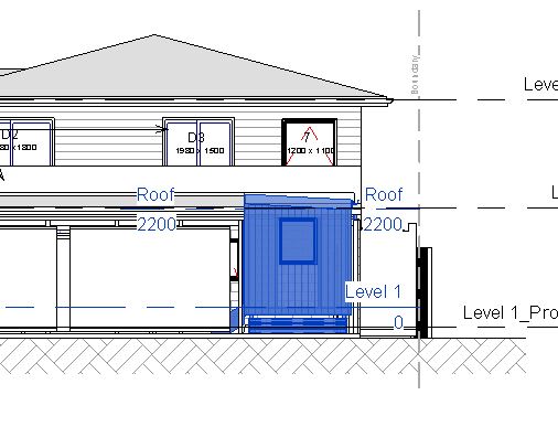

Hi
I want to turn off the level lines in my linked model, i have turned them off in the model but they are still there in the host project.
Can anyone help please
Thu, Aug 21, 2014 at 7:17:26 AM | Turn off level lines in a linked model
In all views, you can control the visibility of linked file categories through the VG tab/linked.  The default setting is to use the VG settings of the host view.  Change that to be independent and then set the VG for the link.

We use links often, and have a different way of doing this:
In the link, we have levels and grids on 'Shared Levels and Grid' workset.
In the host, we have levels and grids on a new 'Levels and Grids' workset. If you turn of visibility of 'Shared Levels and Grids' workset in the host file, all linked levels and grids will be turned of for the entire host file.
