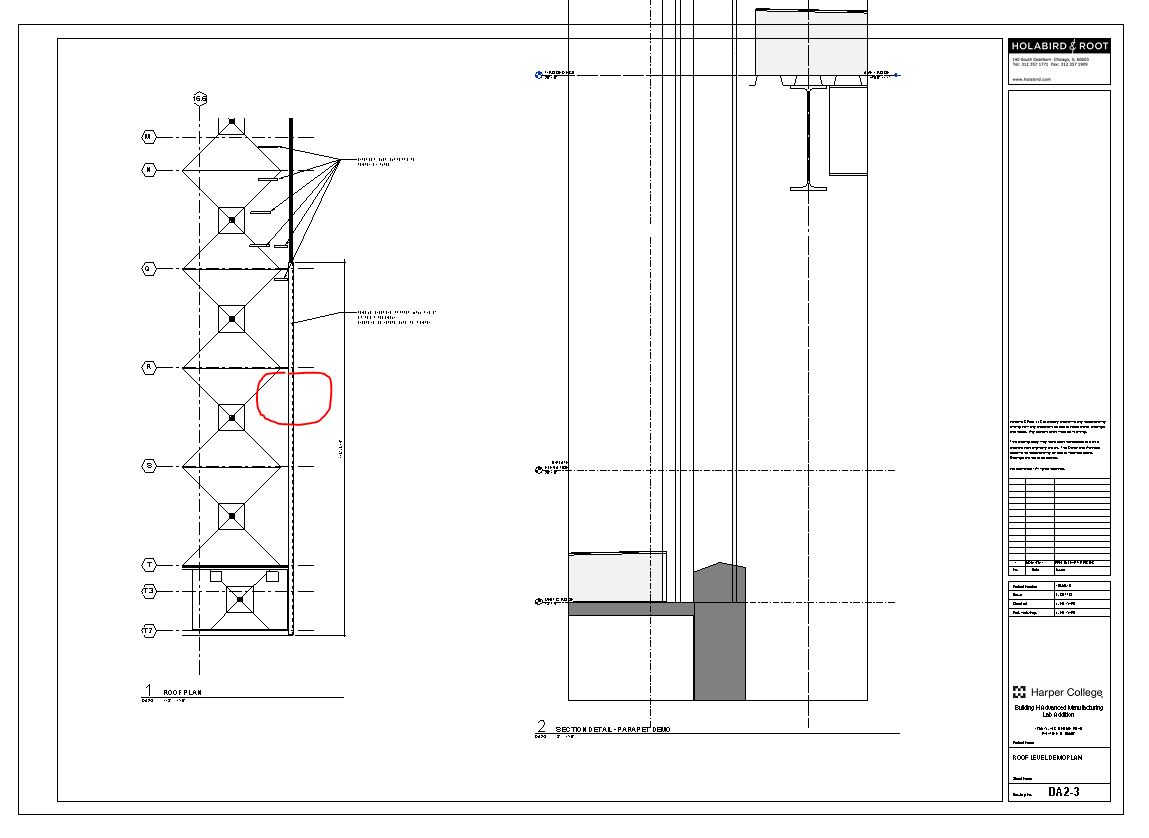

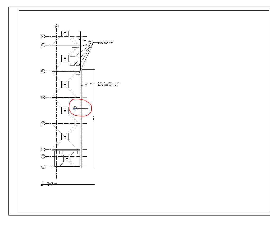

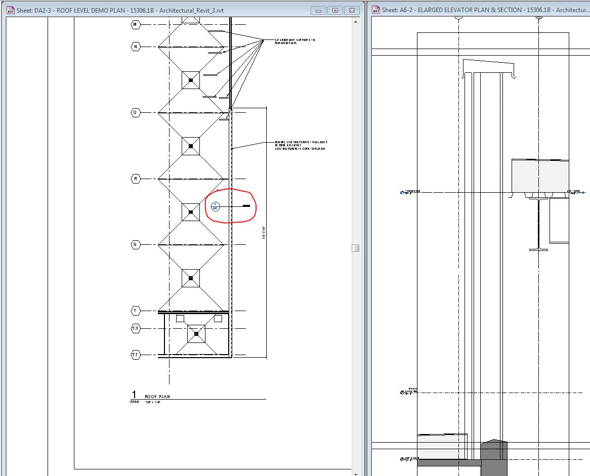

I am a first-time poster and using Revit Architecture 2013.  I'm having an issue placing a detail section on a sheet next to the plan it was created in.  As soon as I place the view, the section line disappears.  However, if I place the view on a different sheet, it does not disappear.
Three images attached:
-Before placing view
-After placing view on same sheet (section line disappears)
-After placing view on different sheet (section line shows just fine)
I'm stumped, please let me know if you hav any idea how I can get that section line to stay. Thanks!

Tue, Aug 19, 2014 at 1:55:56 PM | Section line disappears from plan when section view is placed on same sheet
I just checked it out and I have no problems with this in my 2013.
SOmething else going on here.  It may be a video card issue - How does it print?

I just revisited this problem again today.  I'm convinced that it's a problem with some property of the sheet.  It is currently on a "DA" sheet and it actually works fine if I change the sheet prefix to anything that doesn't start with D.  For example, if I change the "DA" to "AD" it's fine.  Are there any sheet properties that are somehow controlled by the sheet name??
If not, I'll just figure out a way to fake it :/
Thu, Sep 4, 2014 at 7:46:20 AM | Section line disappears from plan when section view is placed on same sheet
There is no sheet property that would do this but we do occassionaly see corrupted sheet.  Delete that sheet and create a new one and place the views on that.  Audit your file.
